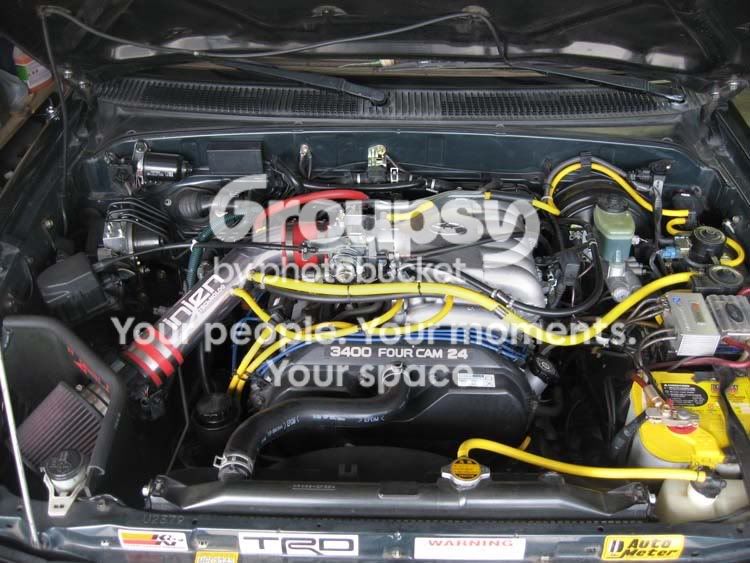

HCurphy, Actually, you are mistaken. There is a positive crankcase ventilation tube (PCV) that comes across from the back of driver's side valve cover and connects to the plastic intake just in front of the TB. That is far too much oily carbon coming from the Left side of the engine. I'd consider a compression check and an oil catch can.
In this picture, the RED vacuum line back by the firewall is the drivers side PCV line
