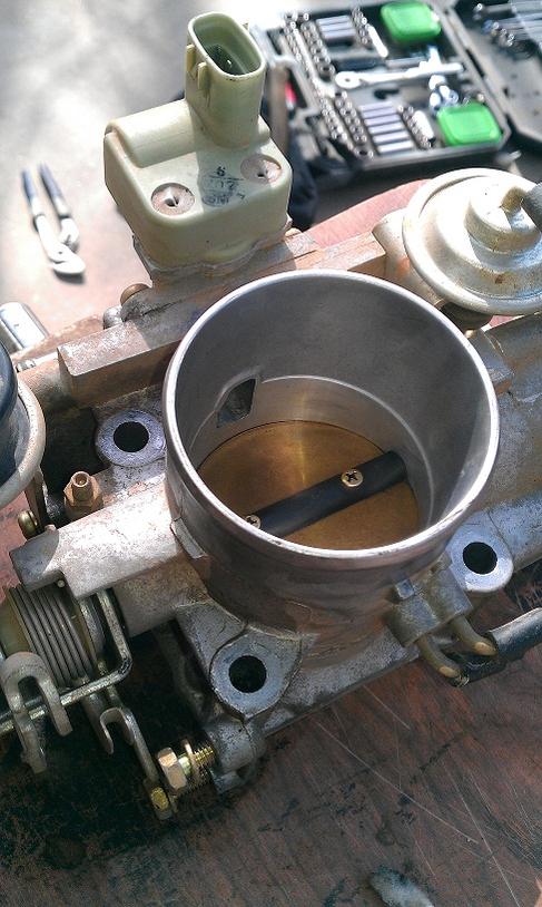

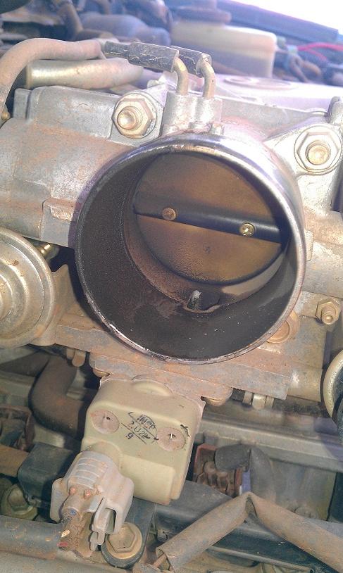

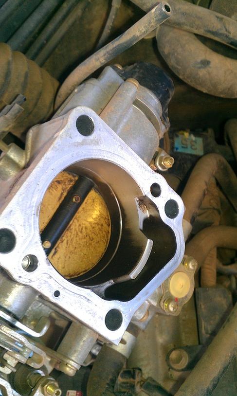

so today is an amazing day out, so figured i would clean the throttle body, maf, and mess with my deckplate mod.
well found the how to looked it over and such, sounded good. took the air box out first after taking all the connections off. well took the tube that gives air to the motor and just said "holy s**t!!", as you can see from the pic there was a little more than a little carbon build up. this c**p was all over and i had to clean EVERYTHING and went through a can of cleaner and about 30 papertowls and 50 Q-tips... it was sssooo bad...
but got it all done and acts way different now. wants to go more now and did 0-60 in 11 sec and could probably do better.
also shortened the screws on my deckplate mod and silicone it all up, including the 2 holes in the bottom of the box.

:wow2: That looks really oily. More than one would expect to see in the TB. This is way above my pay grade but it almosts looks like you are getting some blow-by of the pistons pushing the crankcase nastiness out the PCV. You may want to do a compression test.

PCV dumps into the intake after the TB. Don't think that would be it. (above my pay-grade as well though. I have heard of blow-by fouling spark plugs, never heard about it fouling up the TB?)
