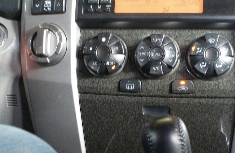

Does the off position on the fan speed arrow of anyone's 4th gen. light up?
I know the back lighting of the climate control's bulbs go out all the time at least so I hear. I replaced a few of mine because they were not working awhile back... All of my back lighting works now and all the arrows that light up work except the off postion on the fan speed, I noticed it the other day it doesn't light up when put in the off position. thanks for any input.
The Off button and the Temp Up/Down buttons have no LEDs in them. You can disassemble them and solder LEDs onto the circuit board though. I've seen posts by people who have done that with success.

I do have dual climate control. Either way I don't care about it lighting up... I thought the light may have been broken and I wanted to attempt to fix it. Sounds like toyota made it to where it didn't work from the factory. Just a pet pev....
led added
