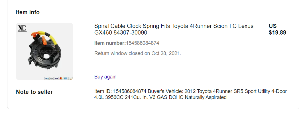

So to reply to myself.... There was a 84307-30090 on ebay for just $20 USD with free shipping so I took a leap. They don't differentiate there in terms of the audio option so I can probalby gripe and get my twenty bucks back if there is an issue. They claim compatability. If it works this will be over 97% less than the genuine part.

This one
Cheap ones seem to be rarer now. You may want to roll the dice and grab this one.
