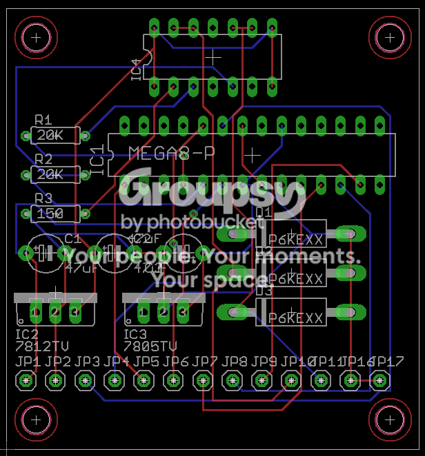

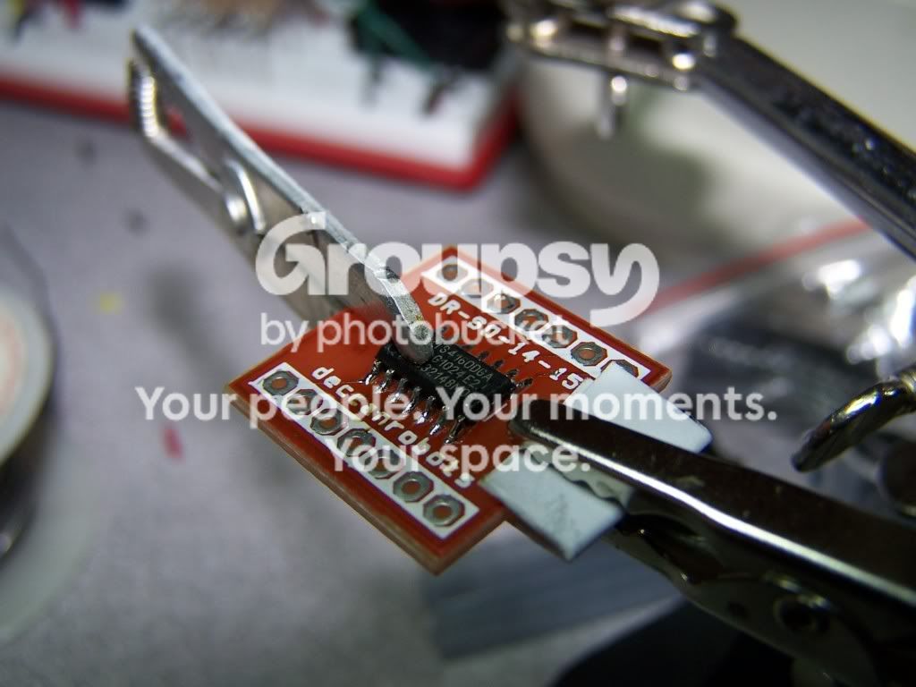

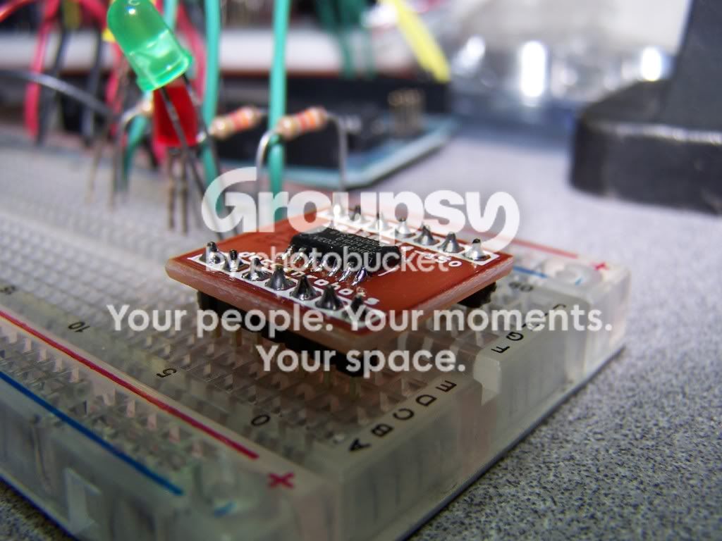

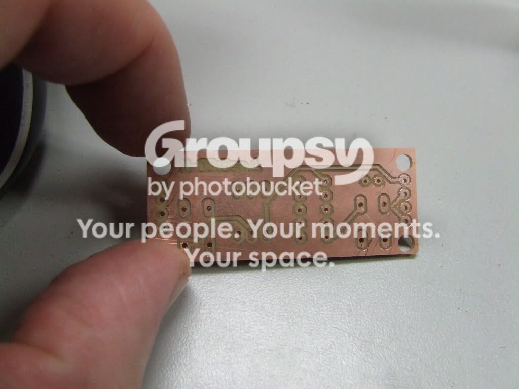

Getting a stk500_recv() error, "programmer not responding" when trying to program the standalone chip, and female headers for the SOIC adapter board ordered.
More building, programming and testing.
100_80821.jpg~original
Big step today. Something was completely screwed up with the Linux version, and it was unable to flash the bootloader. Works now, 2+ weeks to resolve the bootloader thing but moving forward.
Next step, hook it up to the 4Runner or some other vehicle just to make sure it can deal with a noisy environment, cars are the worst. Spurious resets or random behavior are the concern with noise.

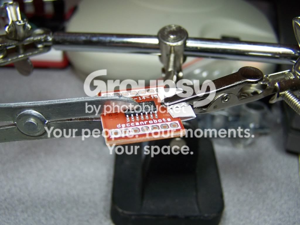

SOIC is successfully soldered along with male headers, so if it ever does fry, a new one can just be plugged right in. Now to wire this chip up and give it some power tests.
