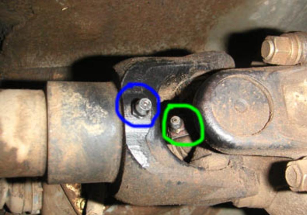

I lubricated the zerk fittings, only one I could not get. But I still get the clunking. I brake hard I sometimes get a clunk before it comes to a complete stop. When I stop at a light and release the brake I get a clunk. What else can be the cause? Can that one zerk fitting that I did not grease be causing all this clunking?
sounds like it the last zerk you missed. you could put the trans in neutral so manually push the car till the other zirk lines up with your grease gun

you have to grease the slip joints of both front and rear drive shafts. It is not as simple as the U-joints. For the u-joints, you just pump a few pumps of grease into it until you see some start to come out from the joint. For the slip joints, however, the best method short of disassembling the whole drive shaft is as follows:
- Pump MANY pumps of grease into the slip joint zerk. Will probably be 20-30 ish, depending. You want to pump until you see the slip joint start to *expand slightly*. That's how you know you've gotten grease all of the way into the joint. Once you see it start to expand, put a couple more pumps in. Stop.
- Use a socket wrench (make sure size is exactly right to avoid stripping it. Not exactly sure what size it is, but it's metric and you'll need a deep socket) to remove the zerk from the shaft.
- Push/jump up and down on the bumper to move the suspension around a few times. This will force the excess grease out of the open zerk hole. The purpose of doing this is to keep that excess grease from having to try to escape from the slip joint, which is theoretically bad for it.
- Once excess grease has been pushed out, put the zerk back on. Don't over-tighten and strip the threads, of course.
- Do this for the rear and front driveshafts assuming you have a 4x4.
****This is the best method I found on this forum. Other people do it differently, I'm sure. It seems that other people just don't put enough grease in there or don't know how much to put. This should fix all clunking.

Blue one is the important one for the thunk. Grease it. Use correct grease. Problem solved.
