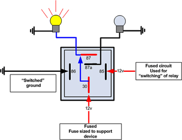

You know I've been using those Bosch relays since I was knee high to Samurai, and I've never seen that exact drawing. Where did you get it? It could be useful for me to 'splain to those electrically challenged.
But then again, I have to pick everything apart. Shouldn't the lighted light be the other one? I mean assuming the relay is at rest. Maybe I'm over thinking it, if I used that diagram I'd put a skull and crossbones on the 87a circuit!

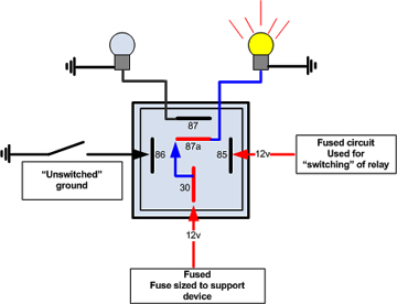

You are correct. I used the relay active view. The "At Rest" is below.
Just right-click and "Save image as..." That's how I stole it after image Googling "Bosch relay wiring" I found this site which has some interesting stuff (for people like us):

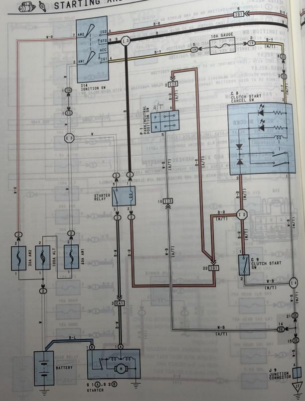

I just wanted to add another 3-Wire CCS EWD to this really great thread. It comes out of the 1997 4Runner EMD Book I was able to score. Hope it's Ok to resurrect an old thread like this.
Two of the four diodes in the 3-wire CCS illuminate the CCS switch text. The other two just keep the switch illumination and operation functions separate.
attachment.php
