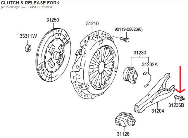

I recently replaced the clutch on a 2000 V6. I also had the flywheel resurfaced. New master and slave cylinders, too. New bushing where the pushrod's fork mates with the clutch pedal, too.
It all went together just fine and I got the clutch pedal adjusted to release/engage at a height I could live with and that was within FSM specs.
However, the adjustment of the master cylinder pushrod required it to extend to its limits. I wondered why. I'm quite sure I removed all the air from the clutch's hydraulics.
It seems to me, and I should stress that this only occurred to me after it all went together, that there's a little tweak one could do to make it so the master cylinder wasn't at the end of its adjustment.
If the flywheel is resurfaced the clutch disk and pressure plate naturally move forward. Thus, the slave pushrod has to extend just a bit farther, too.
What would happen if one were to place a washer under the clutch fork's pivot bolt? (Indicated by an arrow in the picture.) It seems to me that if nothing else, such a washer - equal in thickness to the amount removed from the flywheel - would mean that the slave cylinder rod wouldn't have to extend quite so far. Thus there'd be slightly more adjustment left on the pushrod under the dash.
It's all just a thought. I didn't perform this modification. I invite correction to my thought.
