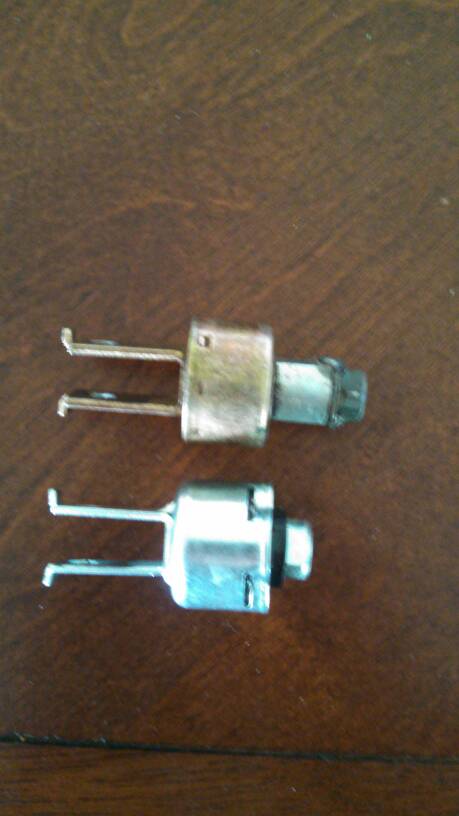

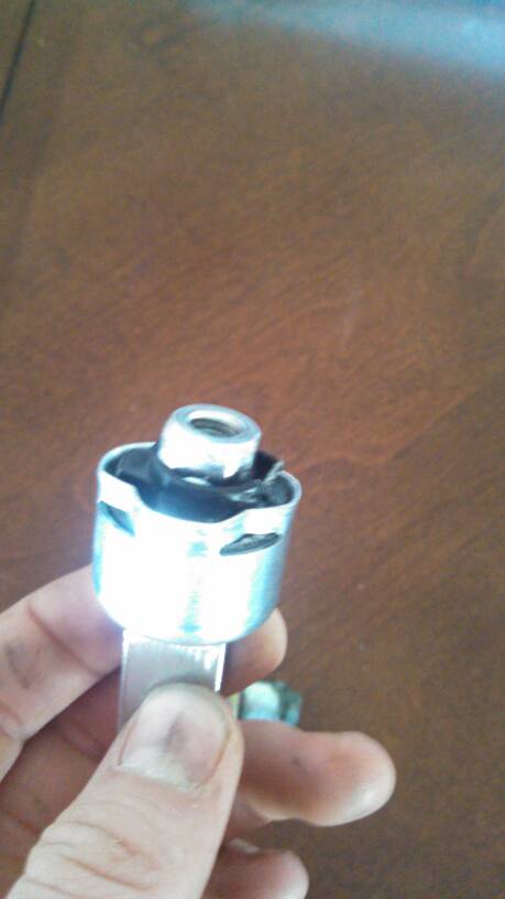

Not sure if this is part of your problem OP, just want to throw this out there for info if anyone else has similar problems.
About three months ago I had to replace the slave cylinder and figured the master would be wise to do as well. The new master cylinder came with a new mounting bracket that connects to the pedal. (The one on the bottom)
Well today coming home from work I couldn't shift at all with out grinding gears. So I pull over because I hear this clicking by the pedal. I see that there are chunks of plastic falling out and with a crescent wrench I was able to adjust the push rod out enough to get home. After talking it out I see that the plastic vibration damper has deteriorated and is bent.
I put on the old stock mount back on that I was sure to keep when I changed the master cylinder and I'm back on the road!
Quick summary: clutch didn't disengage and couldn't shift. Put the stock mount back on and adjusted properly and now it shifts way better.

I also had this problem. I heard the master cylinders from o'reillys dont have that end piece. I was going through one of those like every three months because of that.
