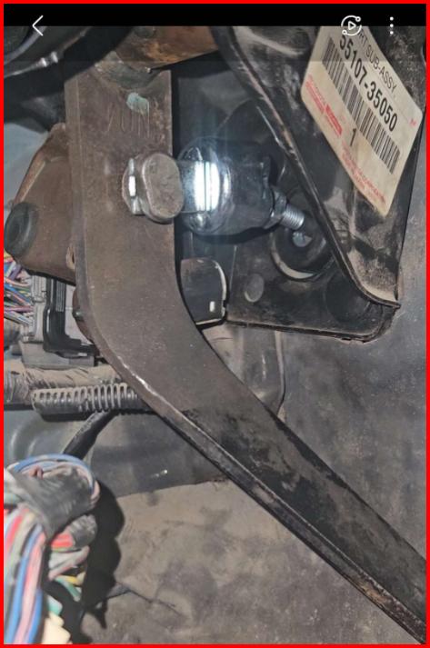

I am trying to find more information about this failure, or any ideas. I have gone through two aftermarket and one OEM clutch master cylinder so far.
I also have very low engagement. I have to have maxed out the rod piston on the clutch master to the point where there are very few threads. If there are any reasonable amount of threads inserted into the pedal fork, I cannot even get in gear.

Is this a factory 5-speed truck or a swap? I see a dealer part number sticker on that clutch pedal bracket...
Also, has it ever been right (engagement point, I mean)? Was it a gradual change or a sudden change? Associated with any other work?

I've replaced the clutch master cylinder and the clutch pedal bracket like you (I had fitment issues with that clutch bracket btw). I never had an issue with a Toyota clutch master cylinder, even the one I replaced was still working fine.
The clutch system is hydraulic like your brakes, and it sounds to me they haven't been bleeding them right because that is exactly what happens when done incorrectly.
Before taking it back, bleed it yourself. It's easy and doesn't require many special tools apart from some clear tubing you can get anywhere.
If you have the adjustment all the way out, it's possible you are pushing the piston in some with the pedal all the way up. At some point, when the piston is pushed in, it will cover up the hole leading the the fluid reservoir, and it can't 'pump up' at this point.
Might not be your issue, and you'd certianly notice this if you were trying to bleed it and no fluid was coming out.

That is a good question, you had me doubting for a moment. The door jam label does say R150F.
I have had it for a few years hoping to build it out and daily drive it at the same time. But the first two masters broke within 100 miles, and then I parked it and started using my 97 4runner instead. I finally had a shop change all the aforementioned parts, and they also said it was necessary to change the clutch master a slave.
I will try and bleed it myself on my next day off and report back. Though if they didn't bleed it right I'd be worried about what else they didn't do right heh. This clutch bracket was on the truck when I bought it, and as Charlie noticed it has the sticker, so that means its been replaced already? I wonder if previous owners have been trying to solve this issue for along time :D

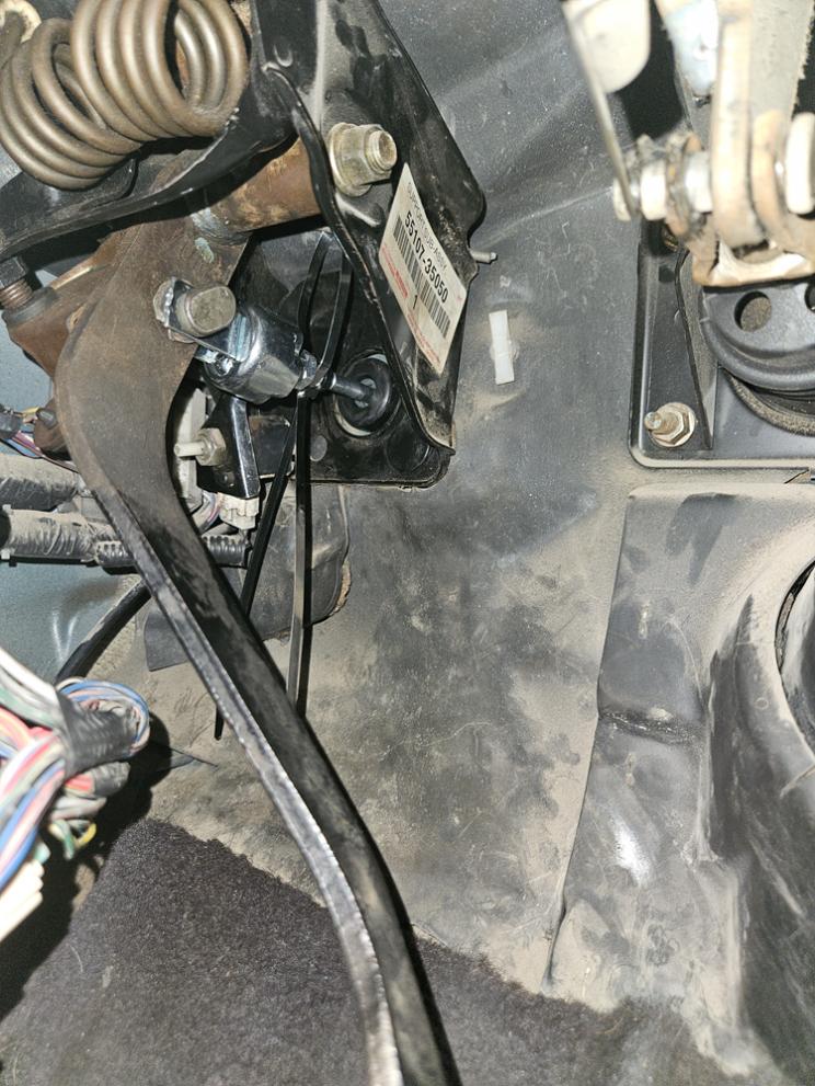

Its not all the way out anymore, I'd say four or five turns in? I did a hackjob to be able to drive the truck currently - flipped the fork upside down so it is bending downwards, and then put a slim punch on top of the bracket, and a metal zip-tie going around the two. It keeps it from bending for now :dance:
Its disgusting, I know, but I need to drive my truck :sobbing:

Just making sure. That part can get worn out if the spring bushings wear out and aren't replaced in time.
Looks like the clevis end is new too - I had one of those go bad on my (highly modified) '89 Camry. That one had a rubber isolator in there that collapsed from long term use and a heavy pressure plate. Make sure that part is in good shape. I just had mine "repaired" by welding it solid... (not sure if the 4Runner might have the same issue)
You really need to set that clevis/rod so that the master cylinder is fully 'relaxed' when the pedal is at the top of its travel. Maybe something got set wrong when the bracket was replaced (upper stop position, etc.). Forcing the master cylinder to over-travel would probably do bad things to it quickly. Check the FSM specs for pedal height, free play, etc. to see if there is anything to adjust.
-Charlie
