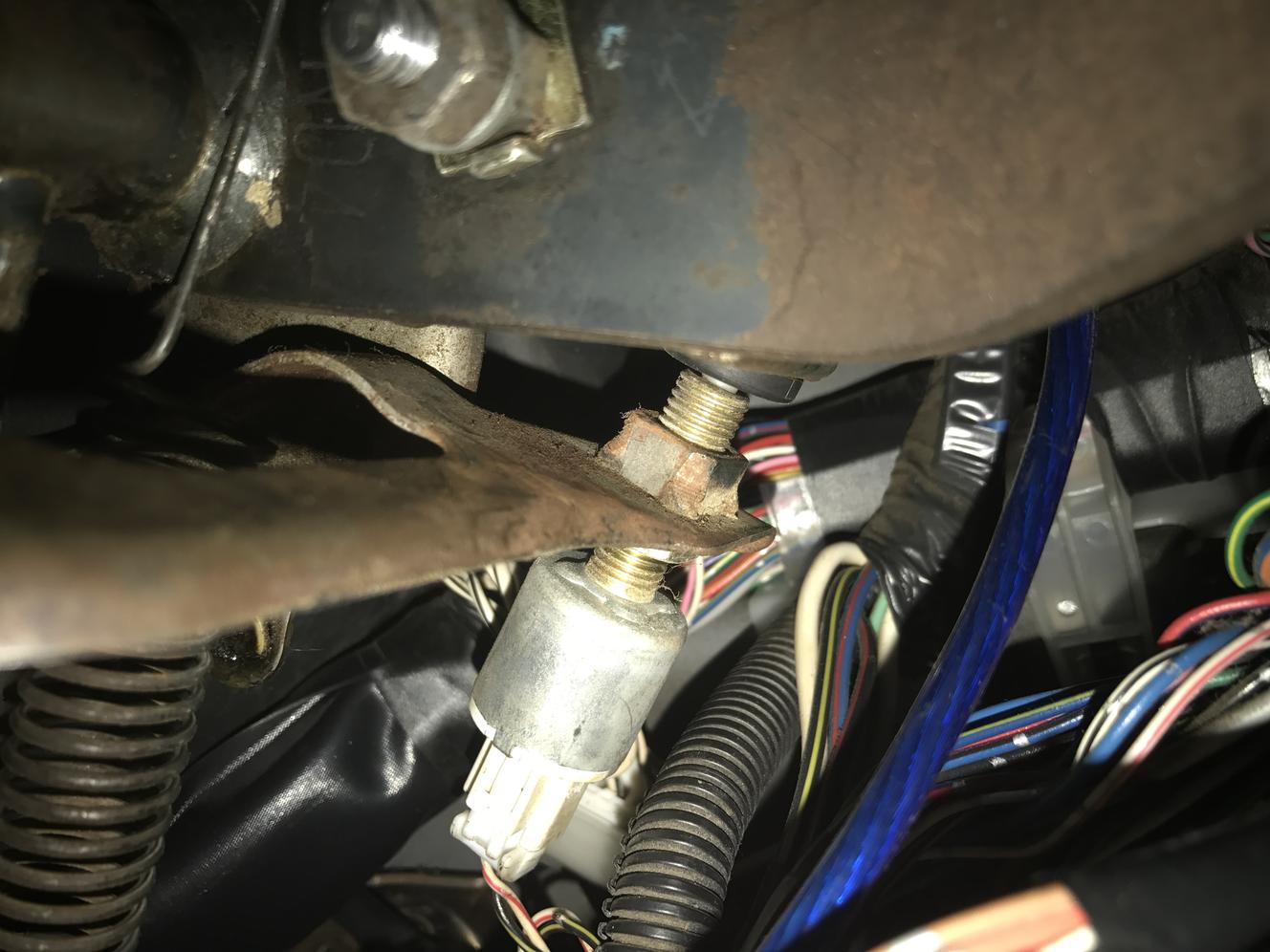

Glad you got it worked out. I am still confused that you did not have any adjustment at the top of the pedal. Are you missing cruise control? There is no threaded switch at the top of the base of the pedal that stops the pedal when you let off the clutch?
This is from my 97 SR5 3.4 My 99 tacoma with a 2.7 has the same switch on the clutch
