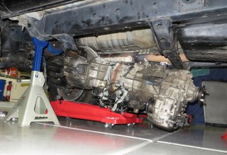

Ultimate pro tip for doing a clutch on any Toyota, don't remove the trans crossmemeber, unbolt the mount and slide the trans back on the crossmemeber with a jack supporting the Tcase, makes it 100% easier going back together.
For clarity: You leave the crossmember attached to the truck body, leave the U mount attached to the crossmember (but detached from the tranny), and position the jack under the Tcase? So as you slide the tranny back the U mount kind of acts as a guide/support.
I could definitely see that saving some hassle... Also would keep you from dropping the tranny inadvertently on your head.
Close, jack up the transfer case and pull the u mount out completely, the flat bottom of the trans rests solidly on the flat top of the crossmember itself., if you want extra security you can wrap a ratchet strap around the frame and suck the trans up towards the floor with it.
Dropping the tranny completely creates a lot of extra hassle, especially if you aren't working off of a lift.
