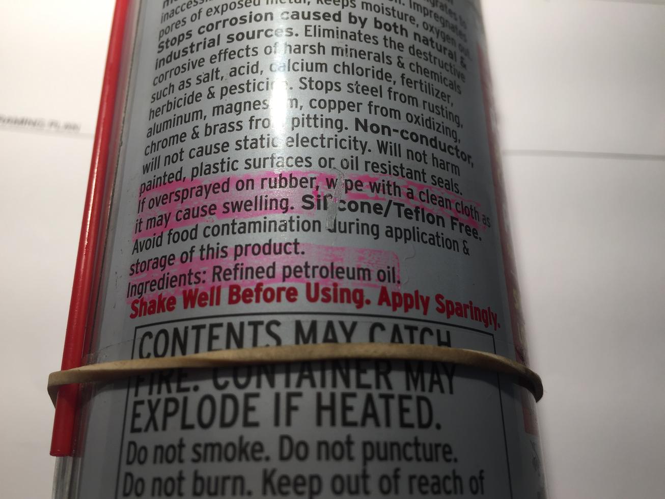

It is petroleum based, and it will make rubber door seals, exhaust hangers, etc swell. It's easy enough to wipe off, but if left- it can make a mess of some rubber, requiring replacement. I replaced a hell of a lot of door seals on my old truck because I ignored this.

Thank you sir. This sounds like need to know info! I checked out numerous reviews on line and the far majority were very complimentary.
No mention of issues with rubber. This is the reason I came to the T4R Household. You guys know by experience.
With this in mind, is the product good enough to apply, taking in to account the time necessary to wipe off every rubber component, or should I pass?
Also, clay can be as fine as baby powder and the manufacturer states that dirt will not build-up or cake on this product.
Does anyone have experience with mud or clay after coating their undercarriage with Fluid Film?

It's great stuff. It pays to be tidy with the application. That's all I wanted to mention.

canada must have a different version of fluid film. the product i have, called fluid film, is lanolin-based. it has the same precaution, ie, may cause swelling to non oil-resistant rubber, but it is non-toxic, and not petroleum-based.
edit:
reading the MSDS, it does contain petroleum distillates. i stand corrected on that. the cans themselves do not list petroleum, only the lanolin based nature of the product.
from the fluid film website:
Technical Data Sheets | Aerosol & Non-Aerosol/ Bulk
FLUID FILM is a penetrant and lubricant also used for corrosion prevention. It is a non-toxic, long lasting, thixotropic liquid that has been used for over fifty years in the highly corrosive marine environment of ships and offshore drilling rigs. More recently they have been introduced and successfully utilized in the aerospace, aircraft and automobile industries as well as for home maintenance. Facilities where they are used include the following: government facilities, commercial fishing concerns, gas companies, agriculture, salt plants, municipal plants, power plants, manufacturing plants and pulp and paper mills.
FLUID FILM is formulated from specially processed wool-wax, highly refined petroleum oils and selected agents to provide corrosion control, penetration, metal wetting and water displacement. The long lasting product contains no solvents, will not dry out and will penetrate to the base of all metals, providing corrosion protection from both natural and industrial atmospheres. Heavily corroded and/or frozen parts such as nuts, bolts, shafts, etc. that would normally be damaged during maintenance, can be salvaged by applying FLUID FILM.
Effect on Rubber ASTM D-471 @ ± 158°F 70 hours
None on neoprene and buna-n. May cause swelling on non oil-resistant rubber goods.

Thanks for clearing things up, guys. I was just basing it off my reading of the can. I personally do not over spray on everything possible, but I do spray the transfer case actuator cover and other items that have plastics, and I have had no trouble. Obviously, do not do anything you aren't comfortable with.
