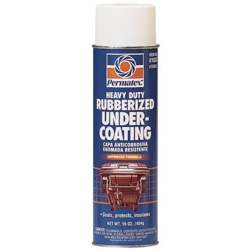

I live in Idaho and used the Berliner in spray cans to coat all frame rails and such, not only has it held up AMAZING it looks really good because it's all blacked out. I didn't clean it before I painted either (it was already somewhat clean) but it still is holding up awesome!! :banana:

I have been using this stuff for years on my vehicles with great success. Along with hitting the rear axle with rustoleum as well.
