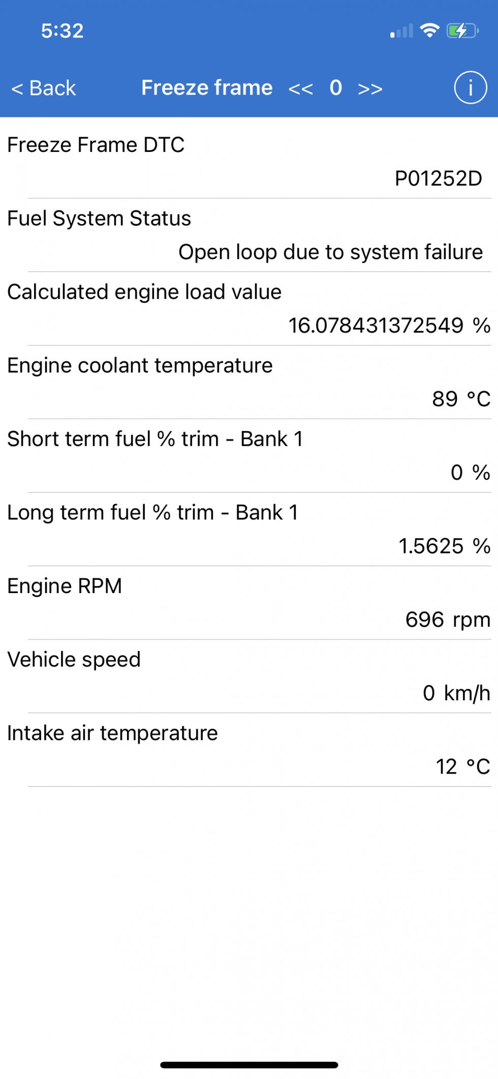

Hi, sorry to dig up an old thread but I cant post a thread because I'm too new.
Ive had a rough go with the exhaust system lately and had one more pop up….
I had a P0420 code. My cat and pipe was in pretty rough shape so I figured id just replace it with an aftermarket one instead of trying to chase the code down. So I replaced the cat with a new aftermarket cat and replaced the fwd o2 sensor because it had become one with the pipe.
A day of driving and I now have P0125. From reading things it seems like its almost never the coolant/fuel system and o2 sensors instead. With recent exhaust work it makes me nervous I screwed something up.
Since my o2 sensors are both the same on the non cali 2000 I swapped them and cleared the code and as soon as it warms up the cel comes back on with the same code. This is a freeze frame of when the the cel comes on. Coolant temp is aprox 190 degrees so its safe to assume its not a thermostat or ect since it is reaching the appropriate temp?

Bank 1 sensor 1 is below 0.1V indicating an open or short in the system. Also the replacement sensor should be Denso or oem.
Yea they are denso 234-4162.
Short in the system….So Im tracking down an electrical error in the wiring harness between the o2 sensor and ecu correct?

Yeah, I was going by what was said in the earlier post. Do you have access to the fsm. If not I can post the trouble shooting pages.

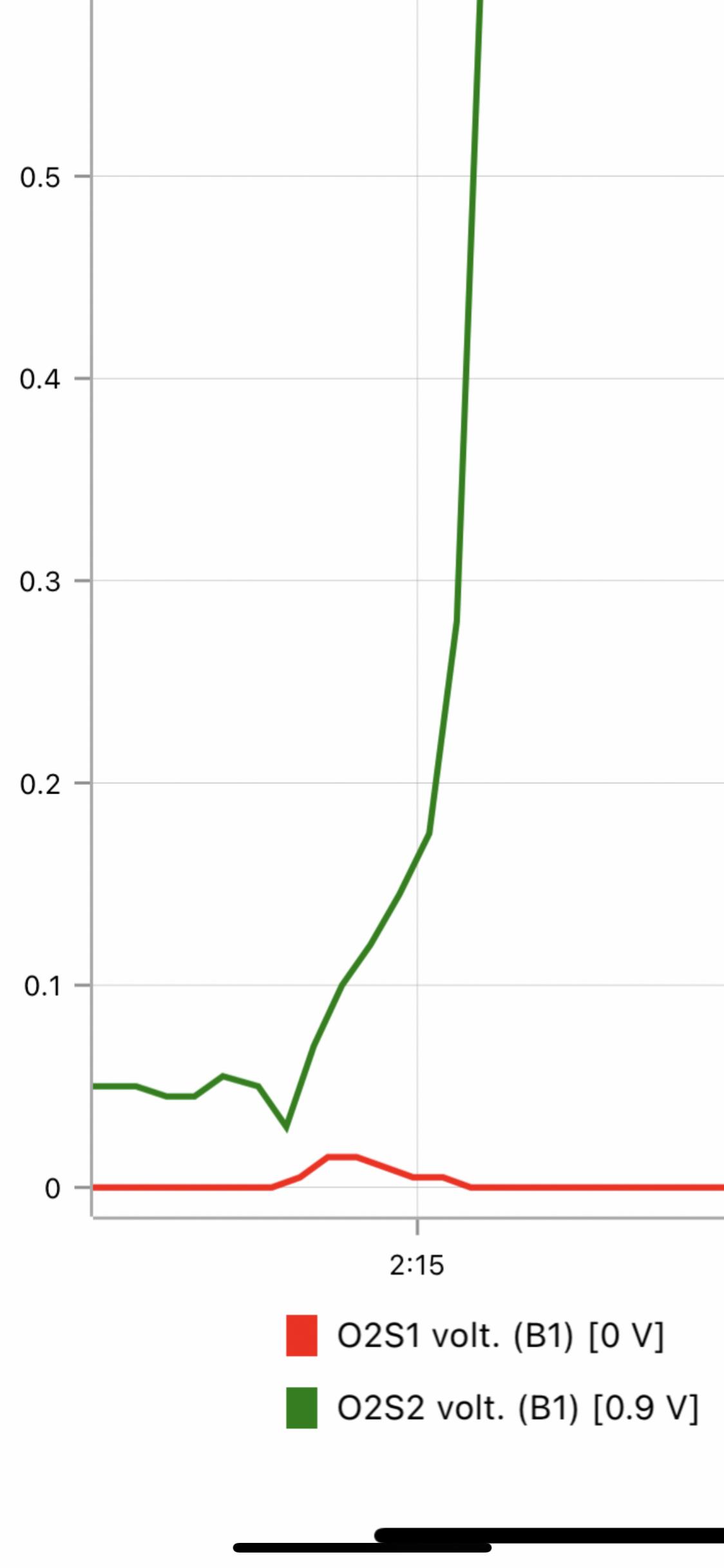

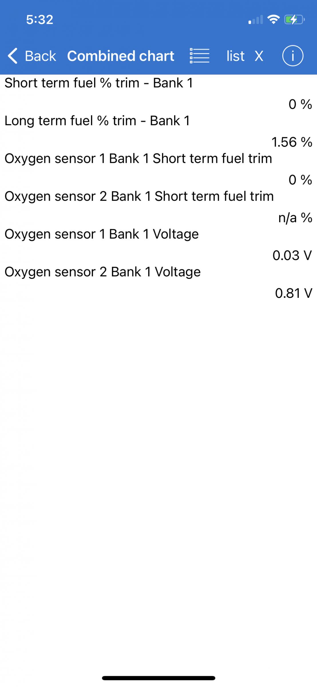

Using your obd when you punch the gas pedal the bank 1 sensor 1 should fluctuate between 0.1V to 0.9 volts. If it's not then there is a problem with the o2 sensor.
Ok thanks, Ill check that in an hour. I doubt its a problem with the actual sensor since I swapped it with the rear one and the code came back on. Ill check voltage and see. Sounds likeIll be chasing a wiring issue
Looks like it is fairly stuck at 0.0. Its a different sensor than yesterdays screen shots and it looks to be putting out the same voltage. So Im guessing there is a wiring issue. It did bump to life momentarily but died back to 0 right away.

you are correct most likely a wiring issue.
