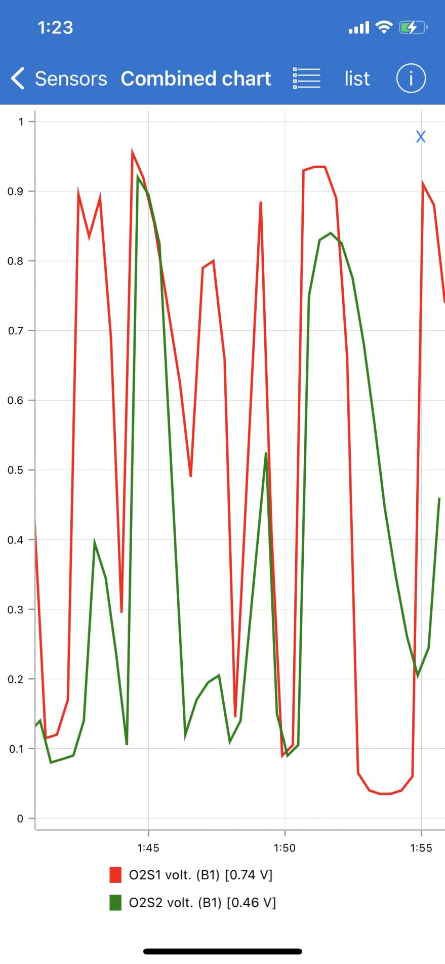

Keep us posted on what you find. At least you got it narrowed down to the wiring and or harness possible issue.
Sent from my SM-A505U using Tapatalk
Well good news. Found a weak connection between a wire and the o2 connector on the truck side of the connector. I butt connected it to the wire on the o2 sensor side as a test. All looks to be functioning properly on the data on my obd2.
Im off to work for a week so redoing the connection inside the connector will have to wait. A butt connector and some electrical tape to keep it dry will work for 1 commute. Thanks for the help guys. Really appreciate it!!
