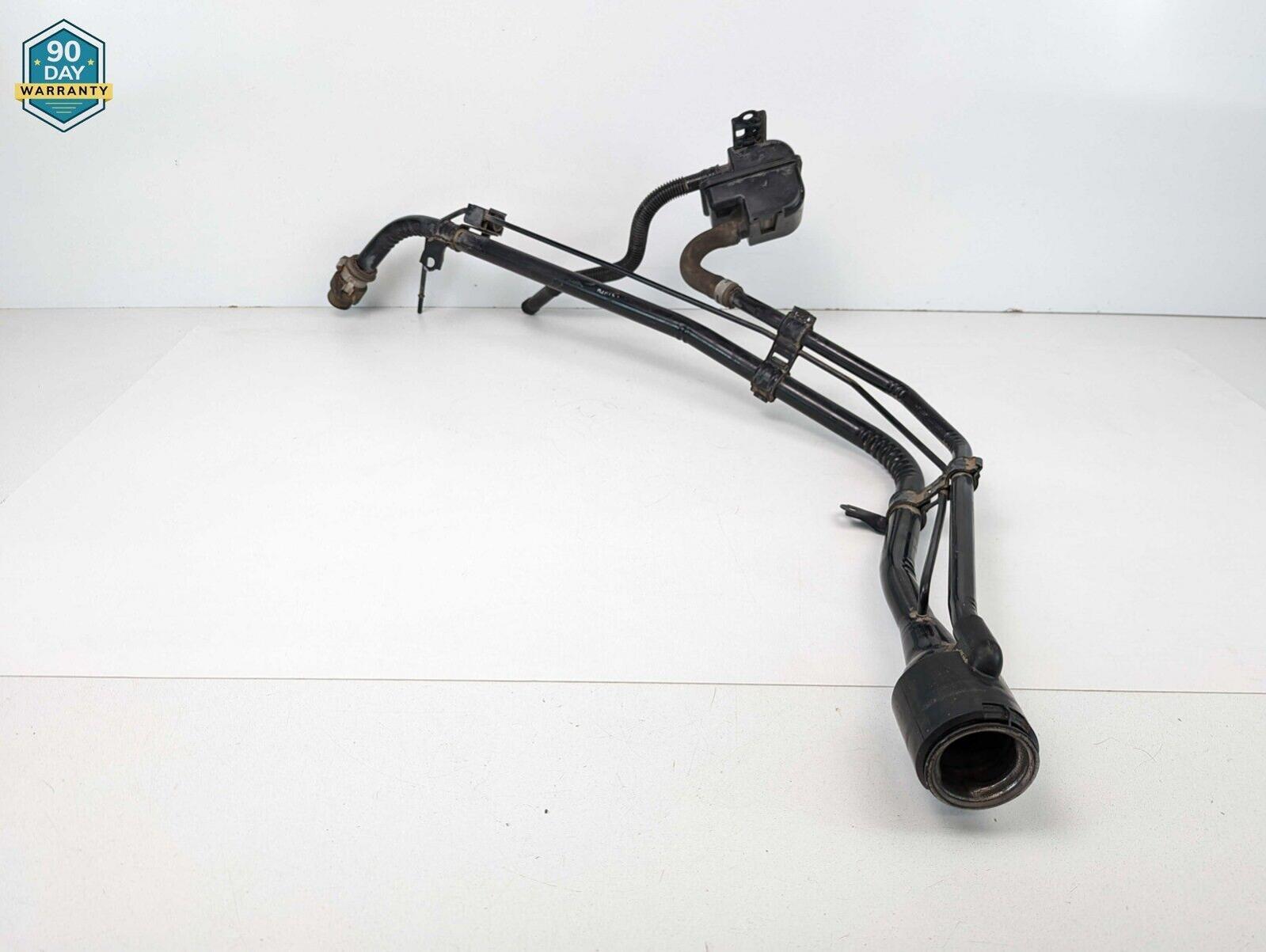

I bought a smoke machine and tested it today. The smoke was venting from the fuel fill area but NOT the cap. It seems to be coming from around the base of the fuel fill neck.
I cant find any other instances of people experiencing this and i dont know if i need to replace the whole filler neck or if there are smaller parts i can replace to maybe fix the leak???
Thanks in advance!!
The only way to know where the leak is, is too locate the exact point of the leak..."seems to be coming from around the base of the fuel fill neck" is not exact enough for anyone to help you, something is either cracked, loose, has a hole in it, etc., you have the smoke machine so it should be rather easy to find the exact point of the leak, no one can find it for you on the forum, we can't see where the smoke is coming out.

That video still doesn't help anyone here to help you find the source of your leak, here's a photo of what you can't see looks like, take your pick as to where the leak is because that's all we can do from your video.

Right I can't tell if it's coming from underneath with that video. Can you look under that spot to see if it's rising from another area? Bust out some tape or something if you can't see. Tape or whatever works to check all the seems joints and what not. You might have to get under the truck..
