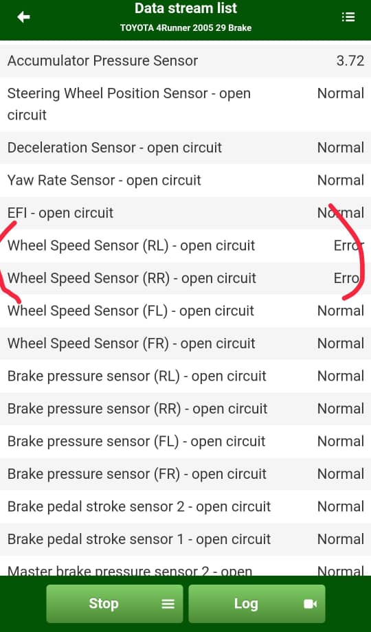

so appears not to be the front sensor, as i thought, got a bluetooth phone app to work with my obd tool, and the codes all point to a malfunctioning rear wheel speed sensor. pulled the sensors and found them covered in grease, wiped and reinserted, lights are still on... am wondering how you tested the harness for continuity?. where do they terminate?.
tested both rear wheel sensors, and the read 0.34ohms, so i believe they are good. its the harness i dont know how to test for continuity. could you enlighten me please

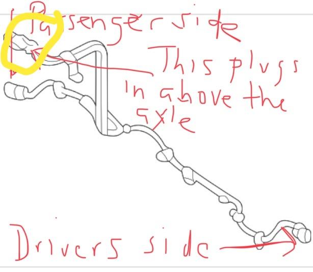

sensors read ok 0.34ohm when tested alone, harness reads ok, when disconnected from sensor, however no continuity when sensor is plugged into harness, and read from the combined harness connector, above the axle. still dont understand how the 2 rear sensors will fail at the same time. am wondering if the failure is further on along the harness?..ie from the harness meeting point (circled in yellow) to the abs ecu/vss??
i am looking at 3 options now,
1. Buy a new harness
2. Trace from the harness connector above axle to the abs ecu/vss (you have any idea where this is?)
3. double my continuity reading again
