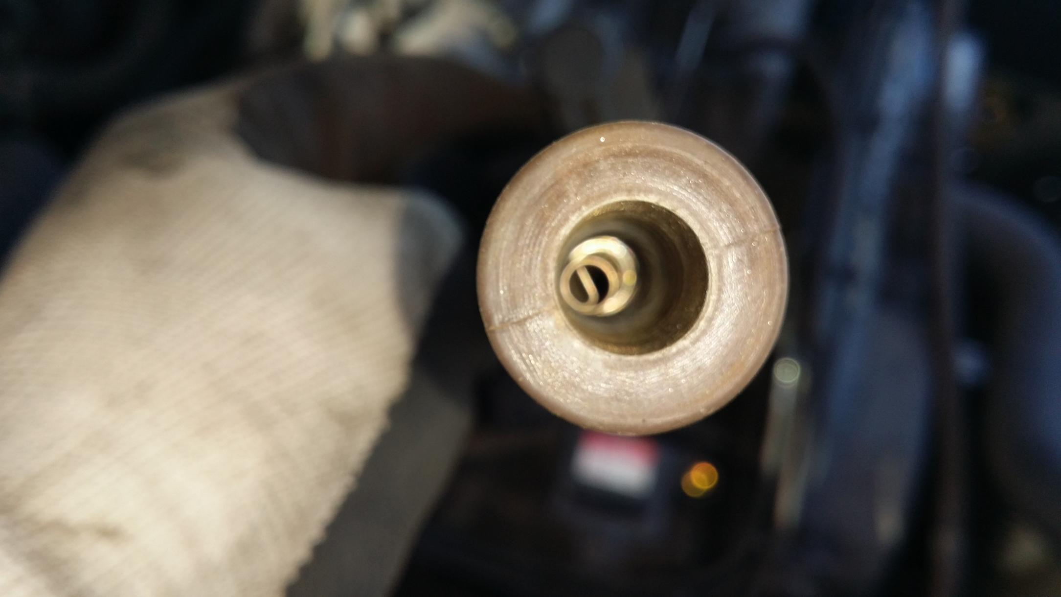

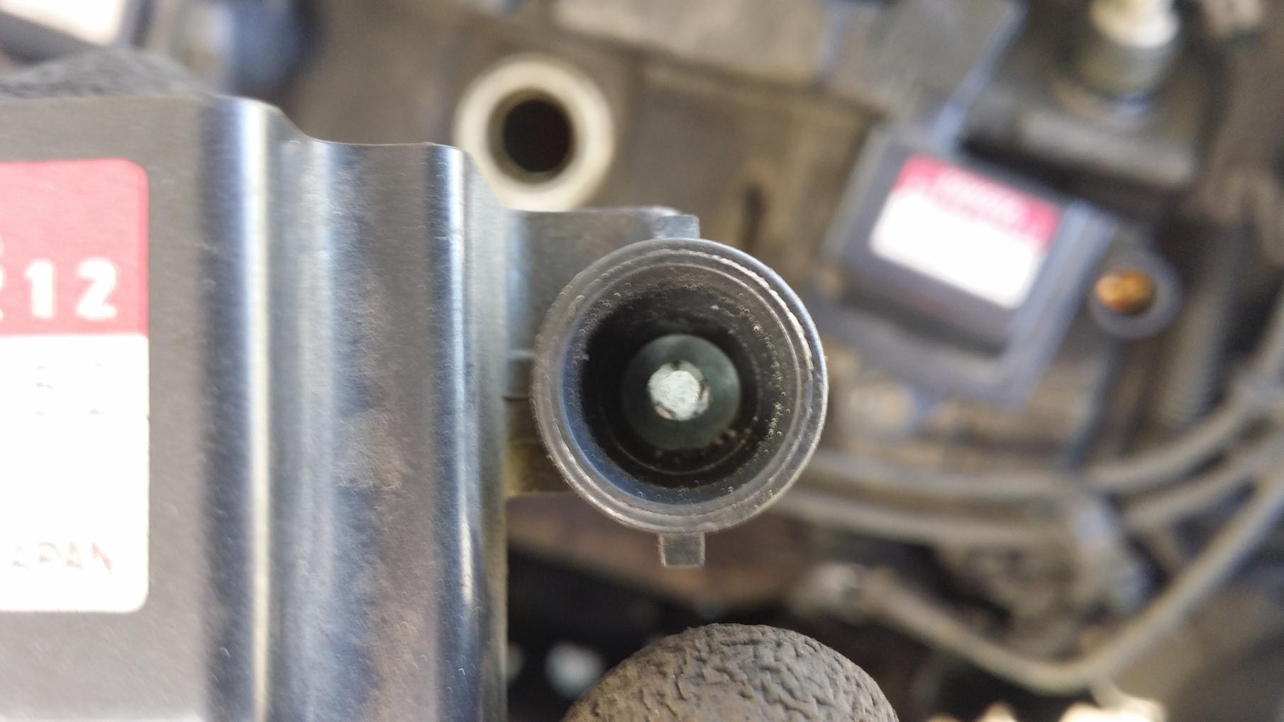

So my last two fill ups i have noticed my mpgs have gone down drastically. Normally i can get about 255 miles to a full tank, these last fill ups i have only gotten 220 or less before completely empty. I made sure when i filled up and each time i could put in 17.4 gallons...
So i decided to dig into the engine and see if i could find the problem. Upon inspecting i found that the contact point with the spark plug wire to the coil pack was all grey/ash colored and the other two were still nice and gold/shiny. Could this be the culprit? and if so would changing all 3 more then likely solve the issue?

do you have a picture of the bad coil? you can also pull all three coils and check the resistance of them to see if it is within spec. use a ohm-meter and check the two prongs where the electrical plug goes and the spark plug spring with the wire-connector pin. not sure of the specs but all three should be the same and if they differ, there is your culprit. could be a bunch of other things as well and since it hasn't thrown a code??? it is hard to narrow it down yet

Check the resistance (ohms) with a multimeter first per the FSM specs, or if any of them are significantly different than the others. It might have been water or a contaminant that entered the wire somehow as well. A multimeter will cost you about $10 at a cheap hardware store if you don't have one.
At the very least, I think you might be due for new spark plug wires since the one seems to be corroded. You could measure the resistance on each wire as well (one prong at each end) but chances are that ash colored one is bad.

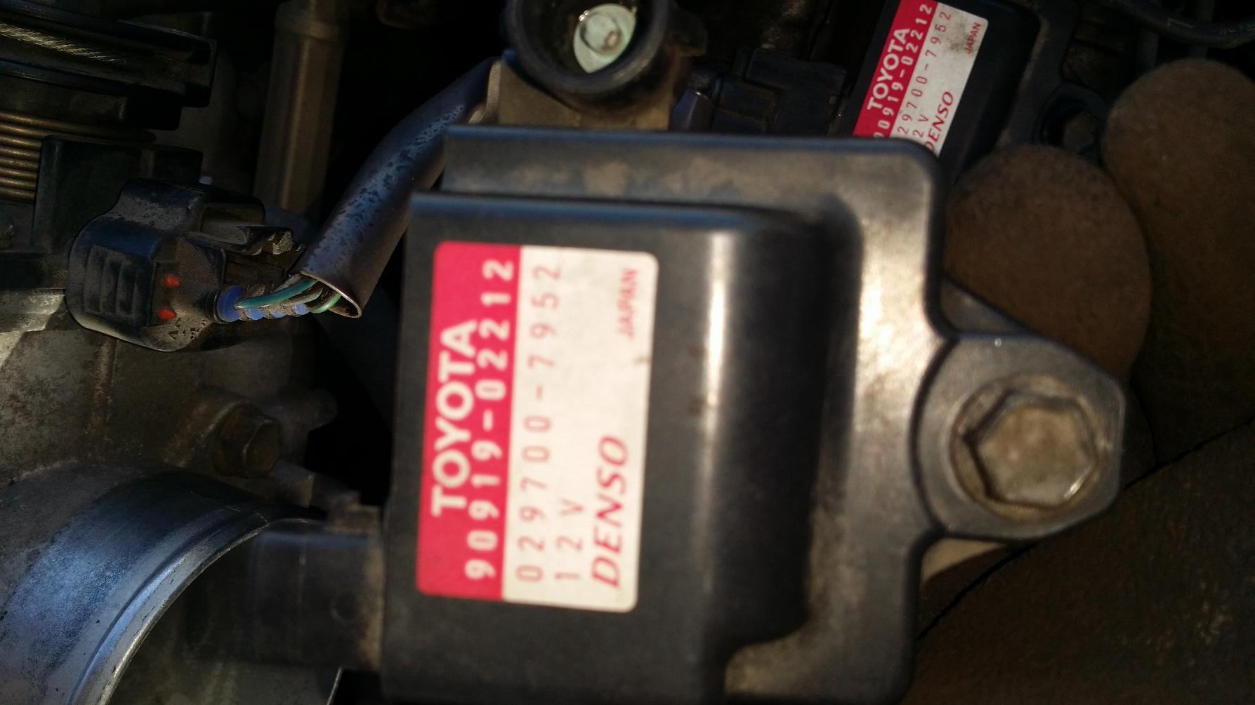

so here is the burned ignition coil
