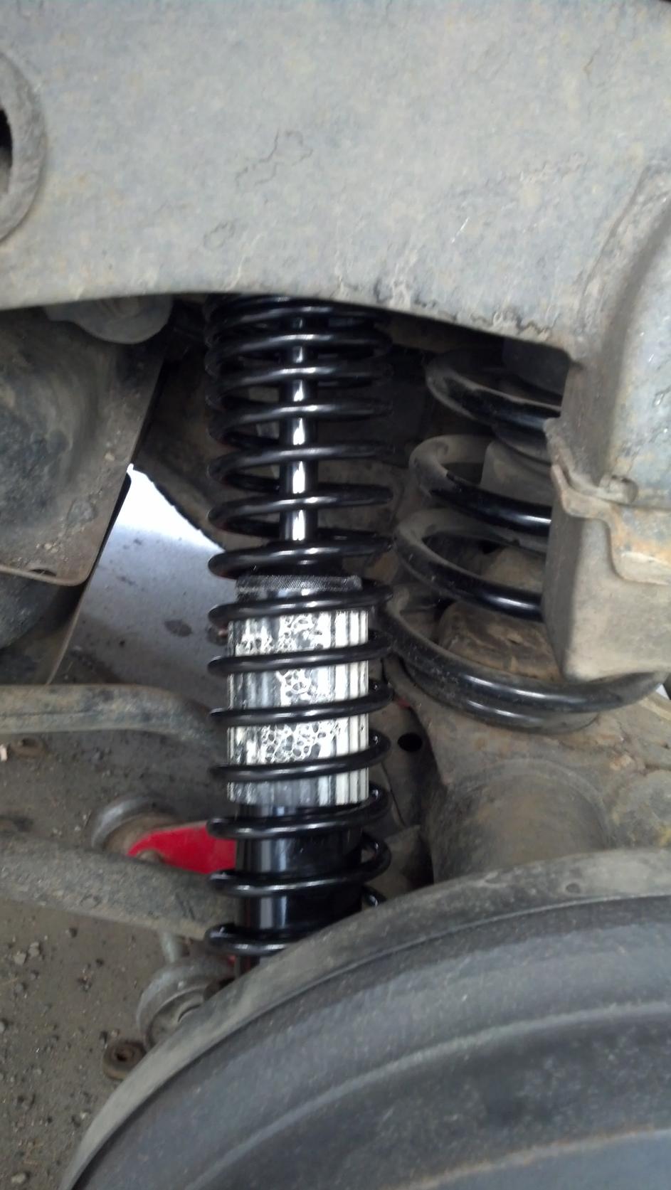

I had the bags for about a year, I was towing a boat trailer and went around a corner and one bag blew out and since there was a cut bump sstop, it dropped one side of my runner about 3 inches. The other bagI saw had weather cracks in it soI had to take that one out too. i Went to my local o'riellys and talked to a guy there and he came up with these:
i believe these were originally for chevy van. Much better than the bags!!! Better ride, only get stiff when they need to (under heavy load). It did lift the back of my truck about a half inch though, I'm sure it will settle.
havnt hit the new bump stops once even under very heavy load, just an idea if u dont want to cut your bump stops and need new shocks anyway. They were like $220 for both.
