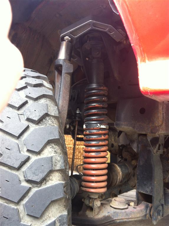

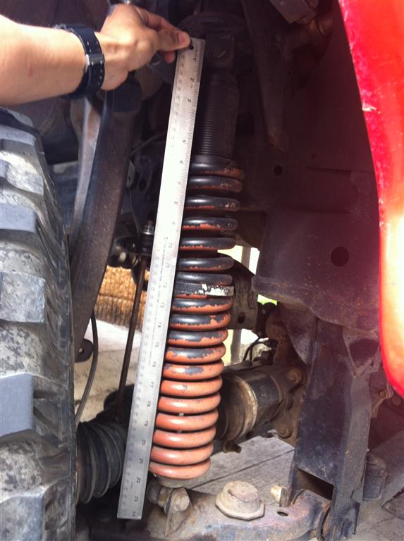

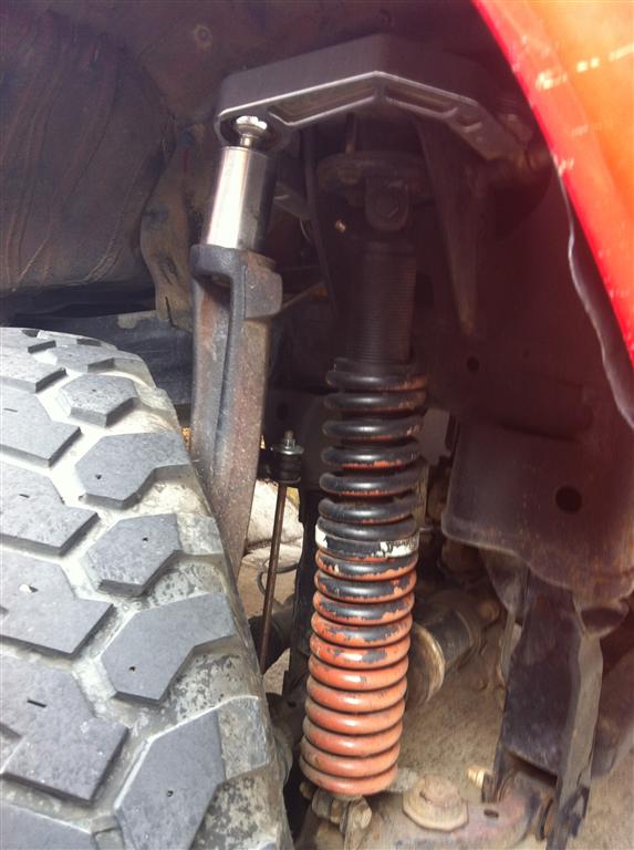

hello guys, im looking for some coil overs replacement for my ride:
see the pics: right now i have the ones on the pics (2 springs), dont really know what brand they are or type, so if any of you have an idea please help with some feedback info.
24" is the normal length when the car is on normal position.
i want to go with solid axle but $$ *-* :dammit::ybrick::wow:

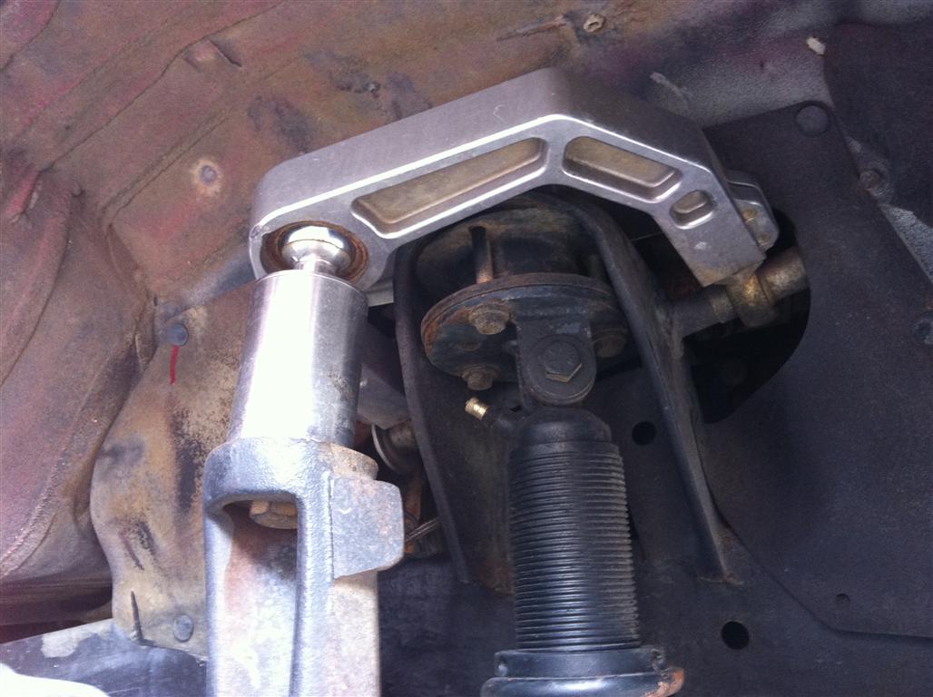

Holy drop bracket lift!! Wow dude that spindle is insanely big along with that extension bolted to the top of it. Hahaha awesome. Looks like a procomp lift though. You may have to contact them for a replacement or get those coilovers rebuilt.

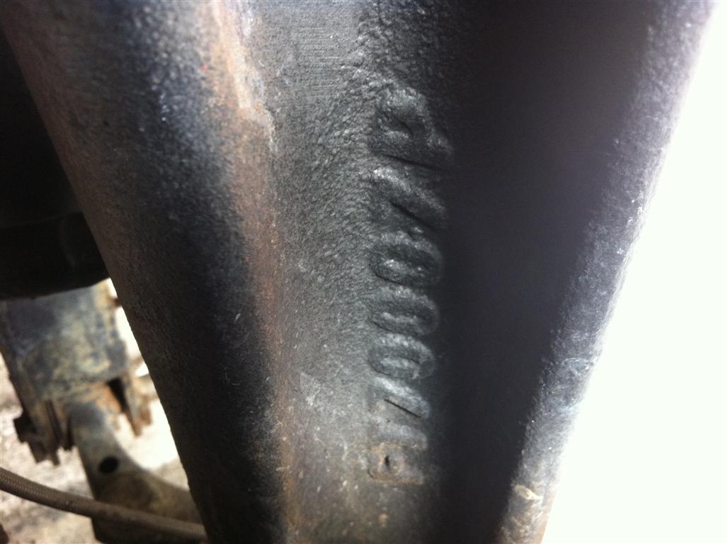

You think the shocks/springs are procomp? i see a couple of fabtech stuff there too, anyway thanks for your response. will try to search at procomp's website.

Oh well if you see Fabtech stamped on on the suspension parts then it might be their kit. I really doubt you will find just the coilovers for sale on the website by themselves just because that lift comes in a whole package. You may have to call them directly and talk to them. Those coilovers look rebuildable though. Any offroad shop should be able do that.
Do you have a full pic of the 4Runner? I've never seen a coilover like that!

It looks like a combination of Fabtech drop bracket, SAW coilovers, Icon UCA's, and some bad decisions.
And maybe alcohol...
IMHO, i would get rid of that setup ASAP. It has to ride horribly with the bottom coils almost to the point of binding. Also, you can see where the uniball is binding on the UCA's probably because those coilovers are way too long.

the ride is not that good thats correct, i was thinking that the double springs were the guilty ones, well, my possible move is, solid axle or sell jeje, ill see what else i can find out, but im guessing that could be the sell part.

Solid axle! Those UCA's retail for almost $1200 new so you could probably get some good money for that stuff that is under there now,

Ho really? which brand you think they are (NEVER MIND I SEE that you posted ICON *-*)? definitely if i dont sell the truck ill swap to solid axle. there is a place near bye that charges around $2500 including parts. with a donor axle for sure.
