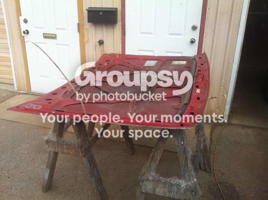

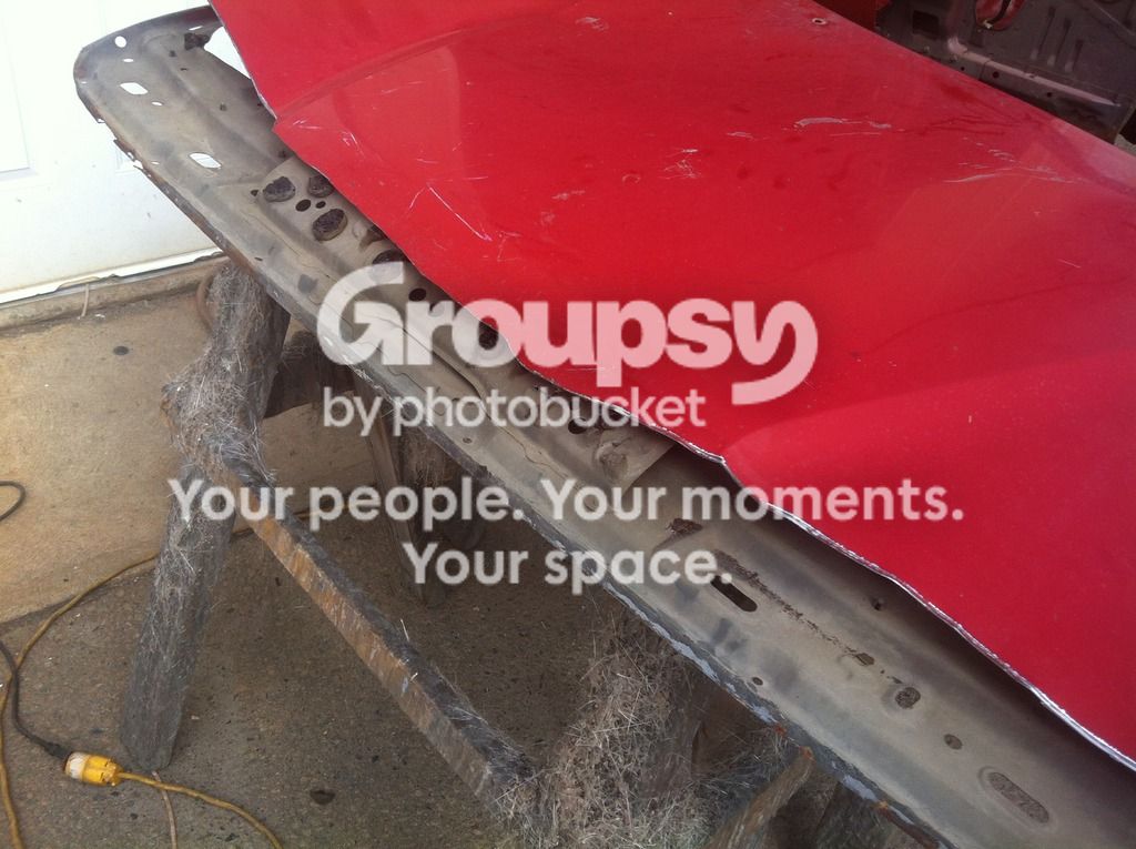

he asked me to install the hood skin I build .. and make it work .
some of you may know , we lost the underside of the actual mould in a fire about 12 years ago , and because of shipping costs .. (total cost delivered ~ $800.00 for the hood) I don't know to many people interested in an 800 dollar hood for there Toyota , so I never rebuilt the moulds .
anyway .. with the truck in my shop , I really wanted to satisfy his request .. I still don't know if it's going to work or not , but I'm gonna try

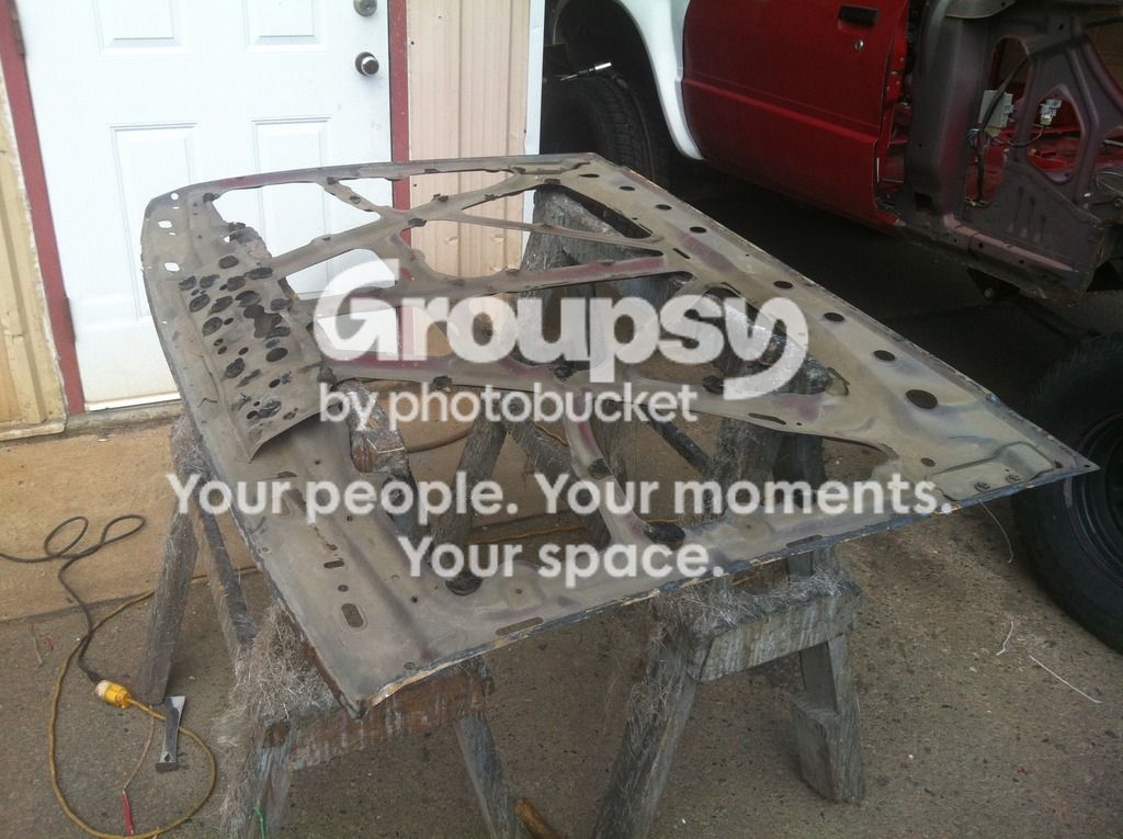

so started cutting the skin off
IMG_0381_zps0wlhxu8t.jpg~original
IMG_0382_zpst2mqx3su.jpg~original
IMG_0383_zpsn41scetm.jpg~original
we'll see what happens .. as I told Zack , no promises on this part

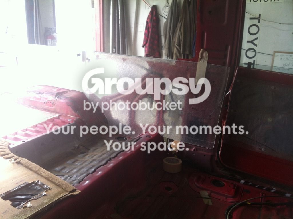

Zack also wanted MAX protection , while we had it stripped , so floor completely scuffed , and ready for some POR 15 .

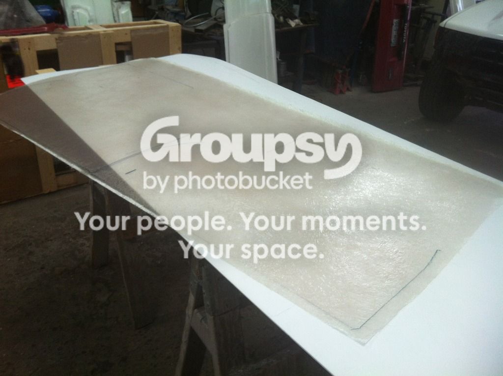

so hood didn't work .. I'm NOT happy , it's garbage

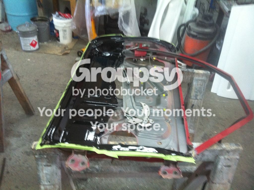

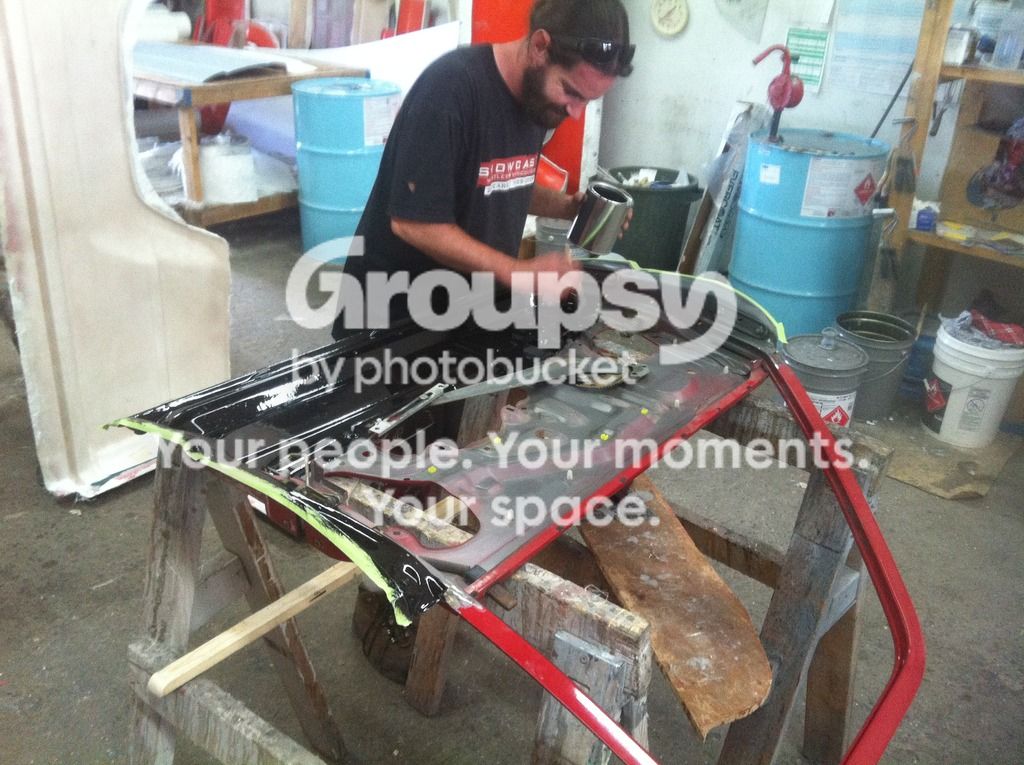

panels back off and ready for POR 15

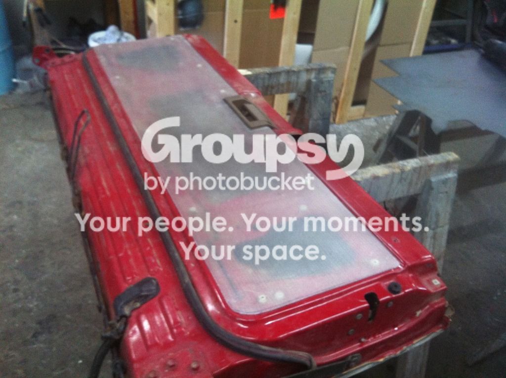

also .. got the gate prepped , POR15's and new skin on

so , just to let you know , the original hood needed to be replaced anyway . Zach wanted our FRP hood skin , so I said I would try . I knew there were a lot of variables to make it work , but I thought I would try .
It could still be done , but because time is money , and this is how I make my living , I had to "call it" ... this typically is how a production mould is made .. lots of trial and error , major amounts of time , until you get a perfect piece . I don't have the "billable" time on this , and I told Zack , if it didn't work I wouldn't charge the time ... anyway

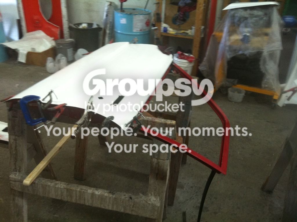

new hood

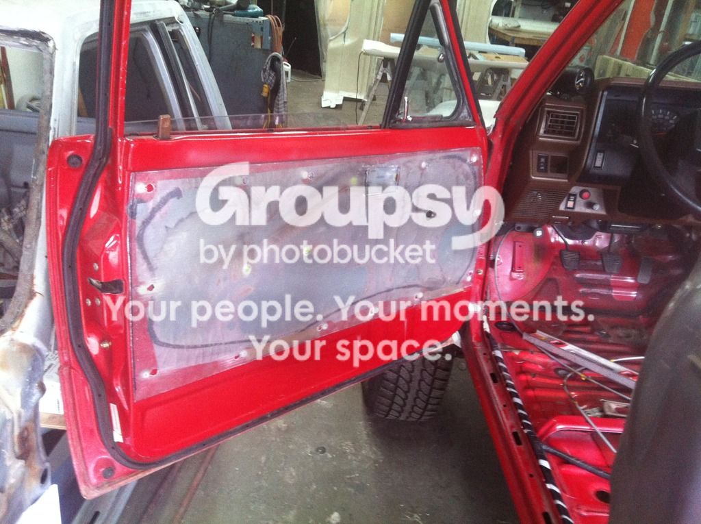

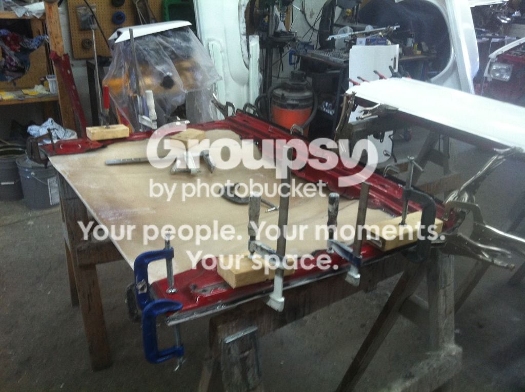

also , doors cured , time to install and trim the gaps
