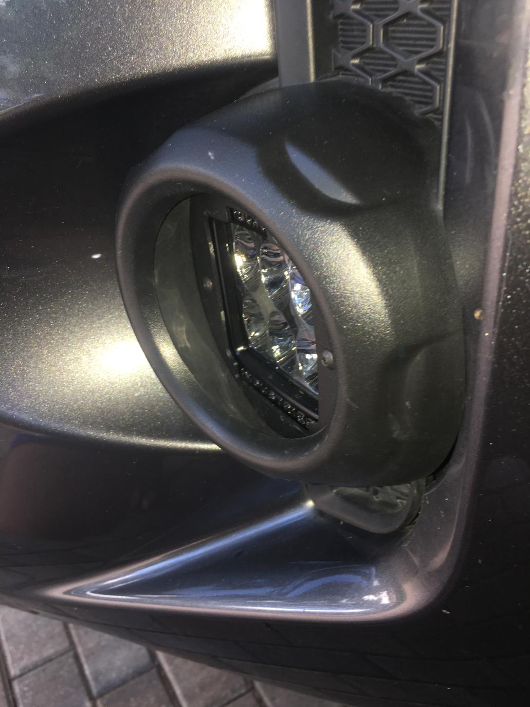

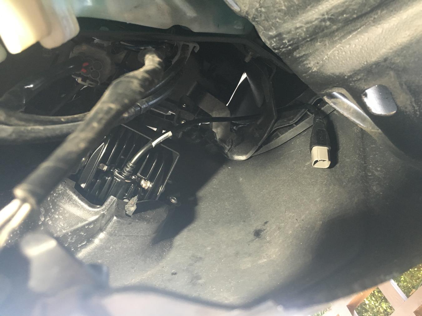

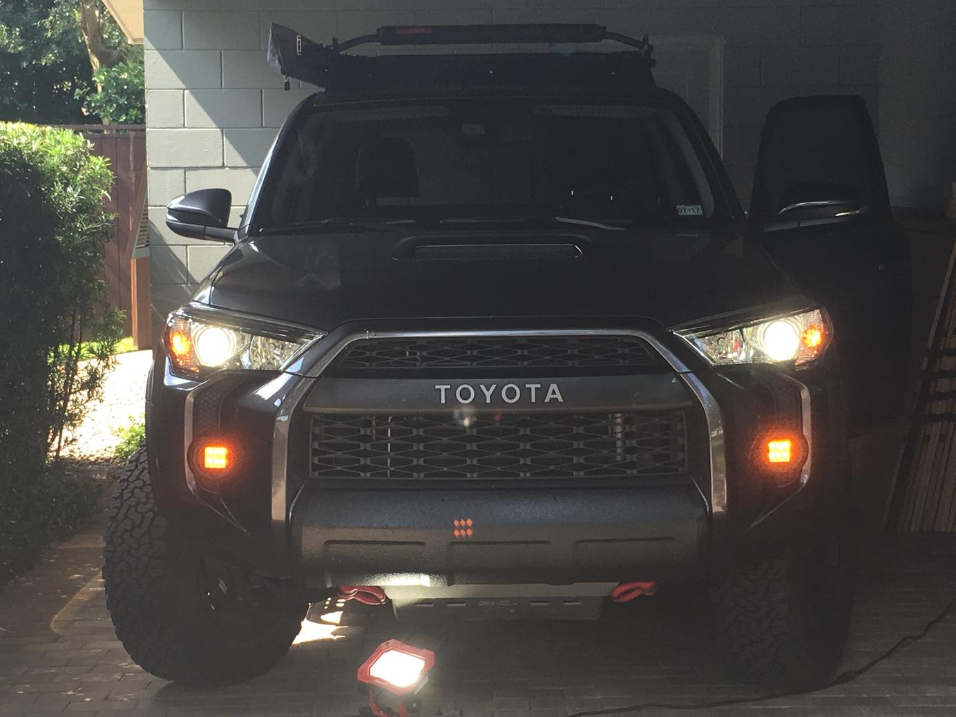

D2 Driving Ambers installed yesterday, everything went smoothly, my pics suck as usual but i'll leave a few notes about the install:
- removed 2 screws from the underside of the fender liner, peeled it back and hooked it around the tie rod to keep it out of the way
- as [MENTION=105498]sovat4r[/MENTION] mentioned earlier, the passenger side has a plastic cover surrounding the fog light that needs to come off as the slots clips into are used for the tab on the bracket and covered by the plate for the mounting screws. it popped off with minimal effort
- the rigid wiring, pnp harness, and factory wiring combined make for a long chain of wiring. to keep this somewhat elevated and from jostling around too much i looped it over a metal brace along the outer side of the bumper cover (shown in pic)
- used some thick rubber gasket type stuff found at surplus store to fill in the angled gap left in front of the light (shown in pic)
