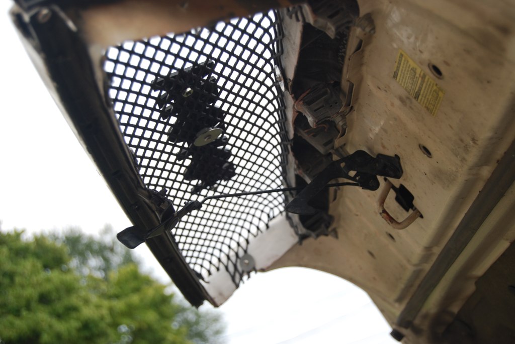

Question for all those Satoshi owners with an emblem. How did you fasten the emblem to your grill? I got the 80s FJ emblem for mine and I am trying to determine a way to mount it without cutting the grill behind to make room for the nubs that are on the back of the emblem.
I want it to lay nicely on the grill but be non destructive to my mesh in case I want to remove it later down the line.
Any ideas?
I've been lucky that I've been able to center all the emblems well and have the nubs protrude through the mesh diamond.
I stack some washers on the back to make it flush with the nubs then use #8x5/8" SS sheet metal screw in the middle and a nut or small washer on the other nubs.

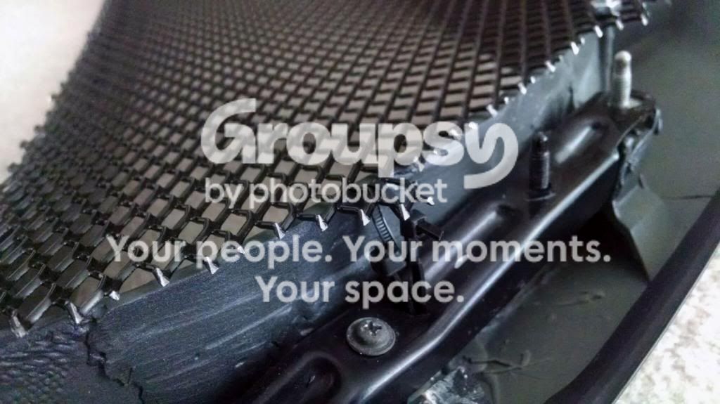

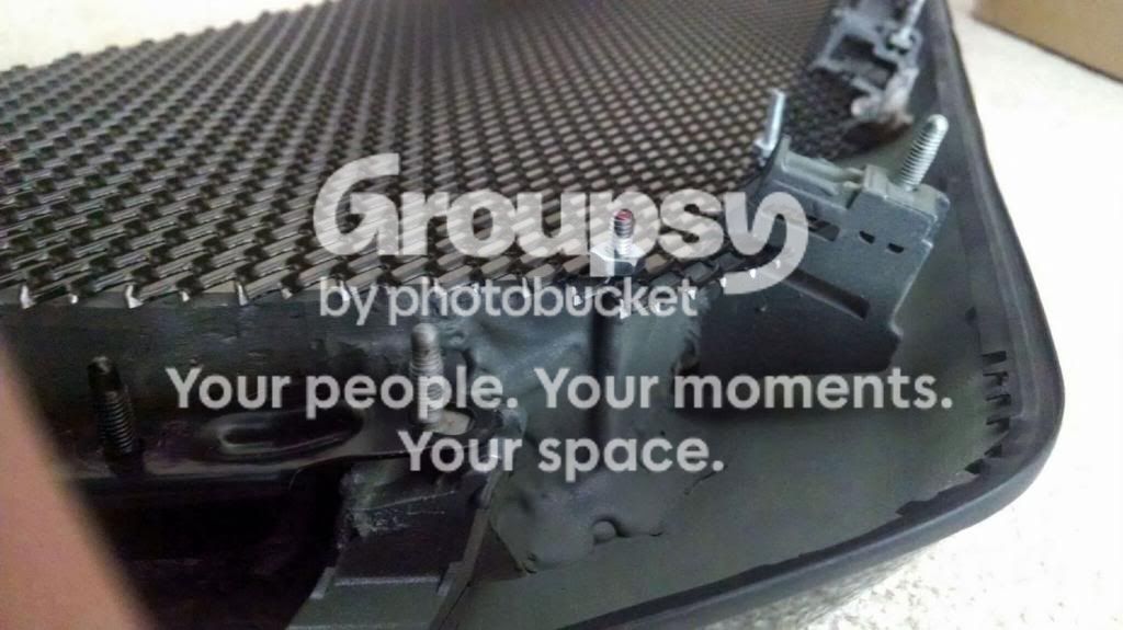

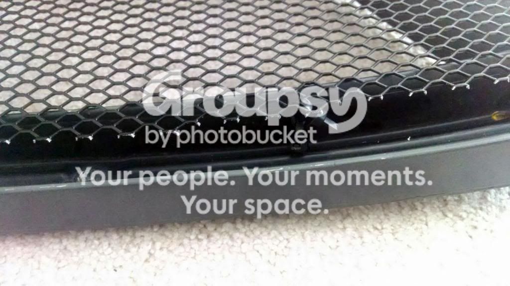

Here is how I attached the mesh to the back of my grille. I chose not to do a flush style mesh so the mesh just sits flat against the back side of the grille. To get the cleanest look possible, I didn't want any screws, bolts, etc visible. On the top, I epoxied threaded rod in 5 spots against the inside lip of the grille opening. I made sure to position my mesh first then marked where the rods would fit into a mesh hole.
IMG_20140101_113007853-1.jpg~original
On the bottom, I decided to drill holes in the black frame support of the grille. I used 2 zip ties to create an anchor point for each hole. One zip tie is zipped closed below the frame and the top zip tie goes down through the hole, through the lower zip tie and back up through the hole and zipped closed. This creates loops to zip tie the mesh to. Overall, it is very sturdy and best of all, you cant see any of the anchors, including the threaded rod from the front of the grille.
IMG_20140101_113056346-1.jpg~original
IMG_20140101_112950549-1.jpg~original

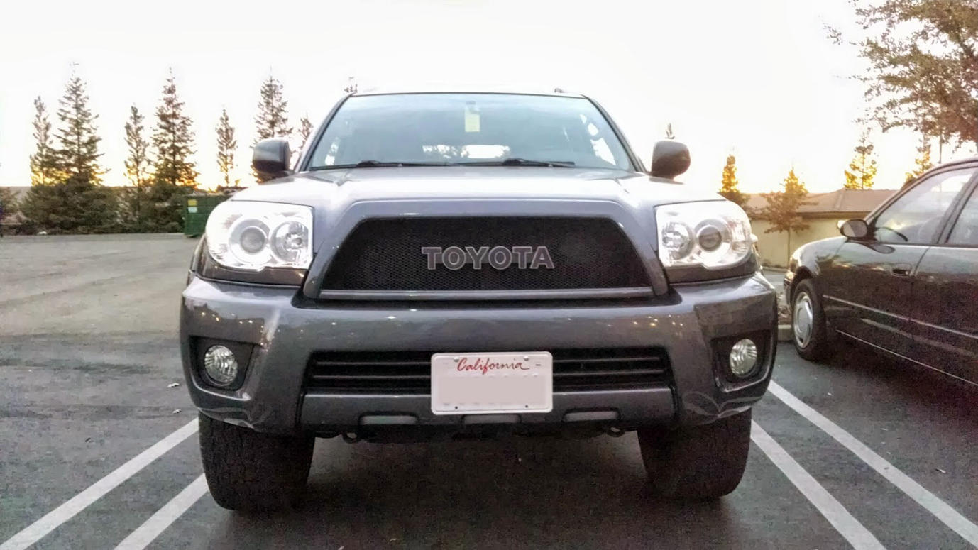

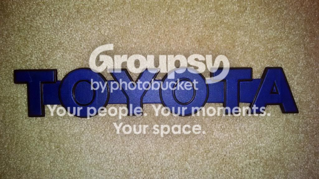

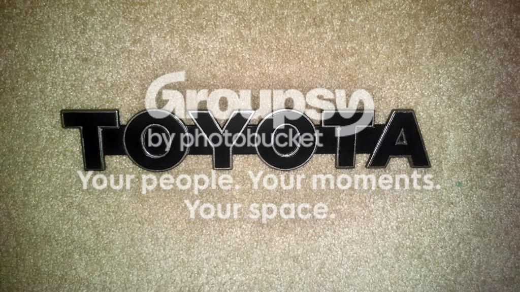

Still trying to figure out what I want to do with my emblem. I have sort of a blacked out theme on my 4runner with my matte black wheels, black mesh in the grille, etc. so I wanted something to match. Unfortunately, I used all my color match paint when painting my grille and im not certain I want to drop some more cash for another can so I went with a dark silver outline for now. Still needs to be touched up but I am not thinking that I like it very much...
Took about an hour to tape off after my base flat black color.
IMG_20140108_205852751.jpg~original
Prior to touchup:
IMG_20140108_232505543.jpg~original

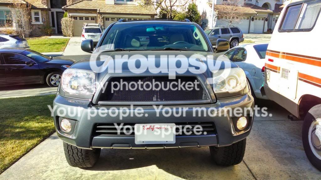

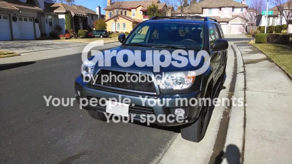

Finished my Satoshi last night and put it in today. Have more pics I will upload from my computer later.
Great job looks good:thumb: Thanks for the write up i'm going to be doing this soon and i want to do the same style you have and also don't have any experience with fiberglass and bondo. Where did you get your mesh from for the grill?
I got mine from custom car grills. I suggest that if you are going to get yours from them and are not sure what style you want, order the large sampler pack. It's $5 but you get a coupon code for $5 off an order over $20. Links to both the site, and sample pack are in the OP under the materials section.

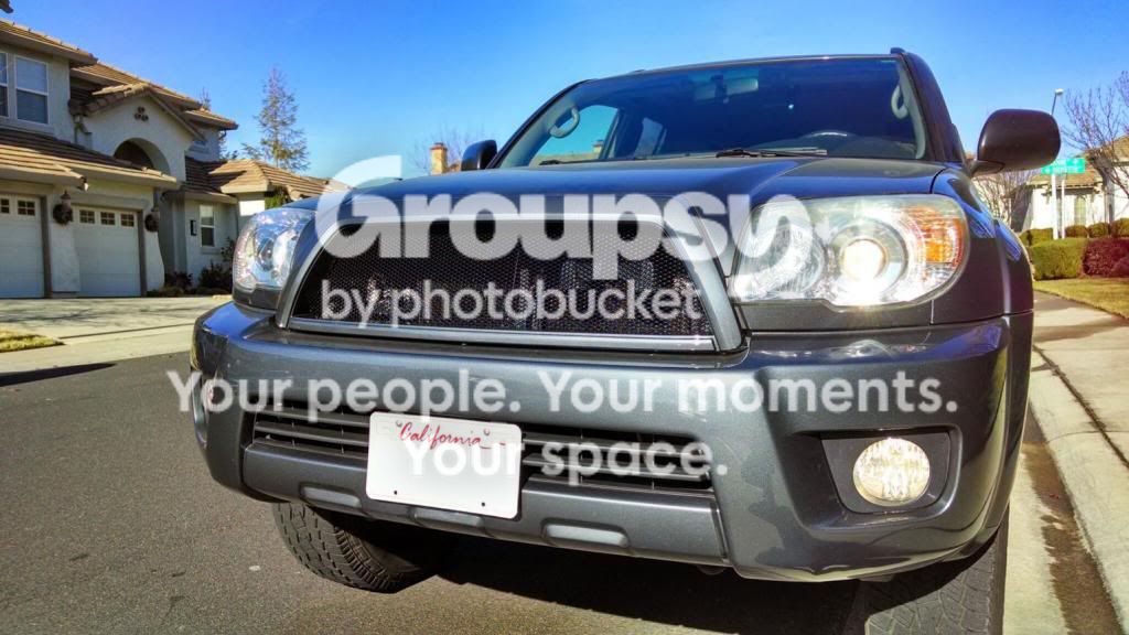

Did a test fit to see how I like the paint job on the emblem (crappy cell phone pic). I like it but am too OCD to have the outline a different color than my 4runner. I ordered some touchup paint and will re-do the emblem with with a galactic grey mica outline.
