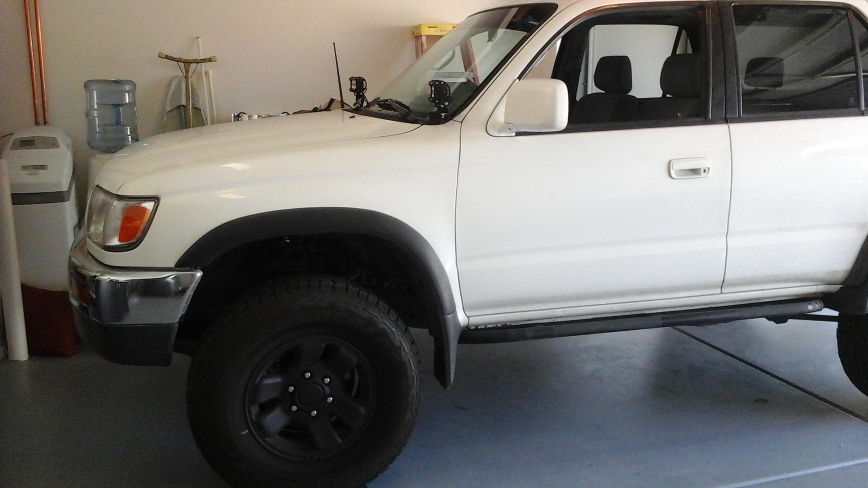

I ran the full OME kit from Toytec on my 2001 Sport Edition. Great suspension. No complaints. Old Man Emu gets my full vote. I just installed Toytec's OME on my 4th Gen V8 and it's perfect.

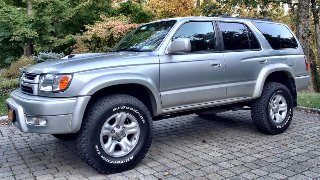

Here's my 3rd Gen with OME from Toytec without the front top plate spacer.

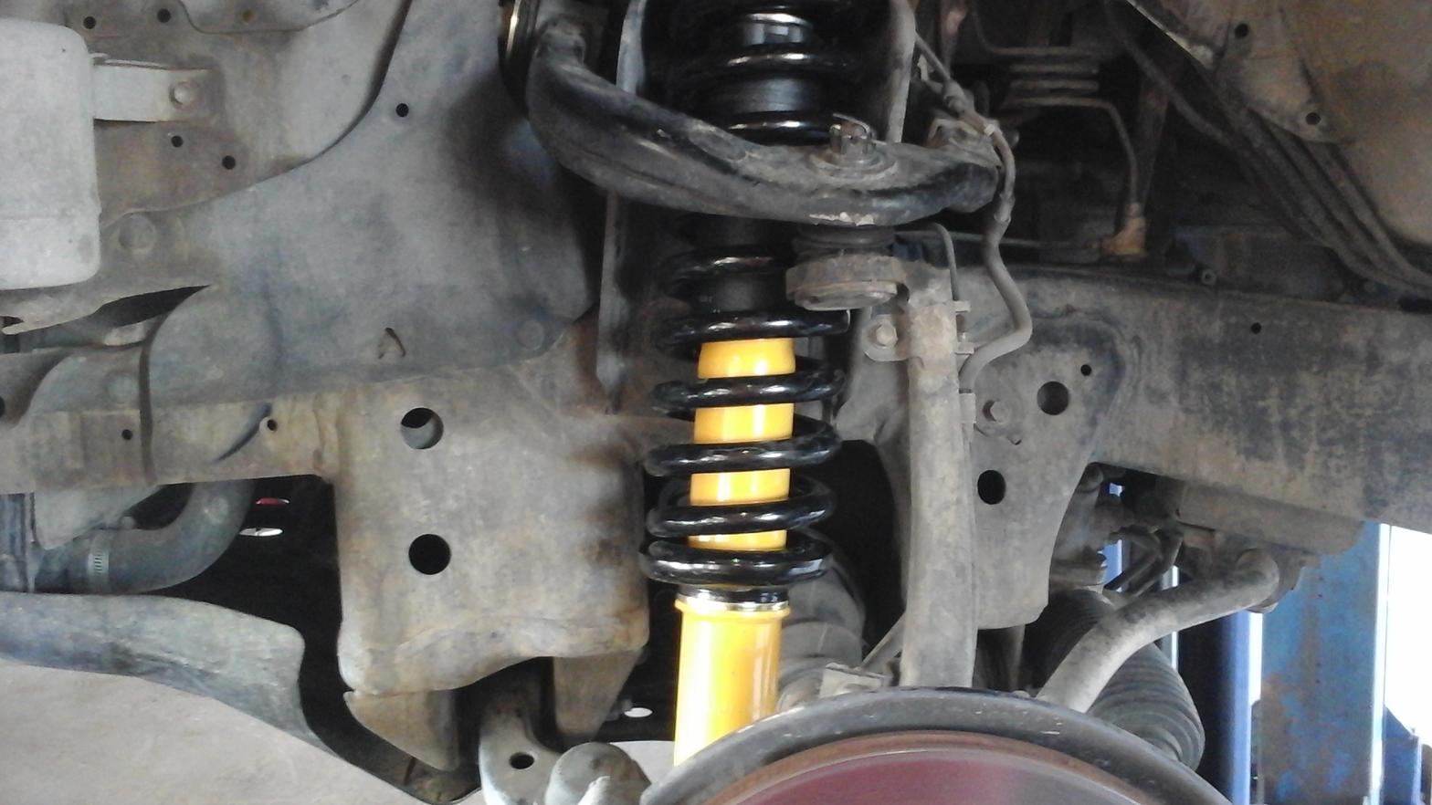

I have been on the OEM 881 890 coils and soft shocks for stock weight for a few months now and I love it. Rides smooth but firm on the streets, soft and way smoother than stock spring and kyb shocks when off road or rough roads i can go a lot faster on rough roads with less harshness to the ride, flexes pretty dam well and lastly looks good. I had no iusses with the install, alignment or rubbing of spindle on coil which is common with the Tundra coils.

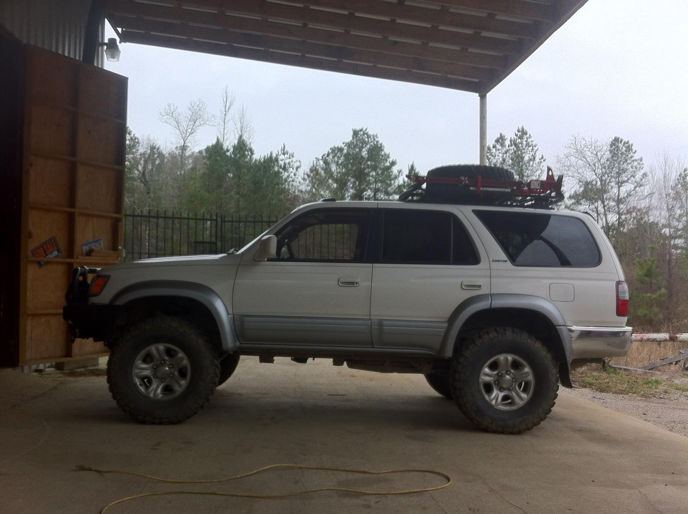

Here's mine with the 3" HD OME, With winch and ARB bumper. No sagging and it's been on a year so I think you would be fine
