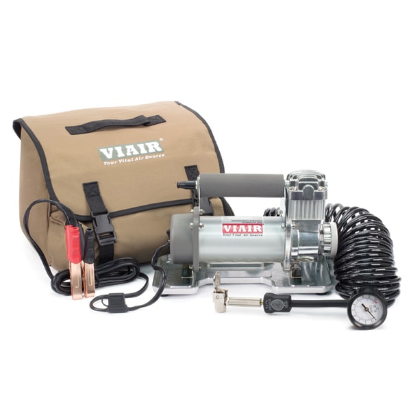

If you're airing down to 15 from 35 x 4 tires, you'll Need at the Very least this:
https://www.amazon.com/VIAIR-30033-...tive&sprefix=viair+300P,automotive,214&sr=1-2
Not even at this price point do you get 100% duty cycle (33% on 300 P) so you'll need to keep an eye so to speak on the temps. Mind has not overheated when airing up 4 tires (265/75/16) from 15-35 yet still takes some patience cooling off a bit between the 3-4th tire. Takes 4 mins per tire from 15-35.
This one is 100% duty cycle: https://www.amazon.com/dp/B000X9EGFS/ref=emc_b_5_t

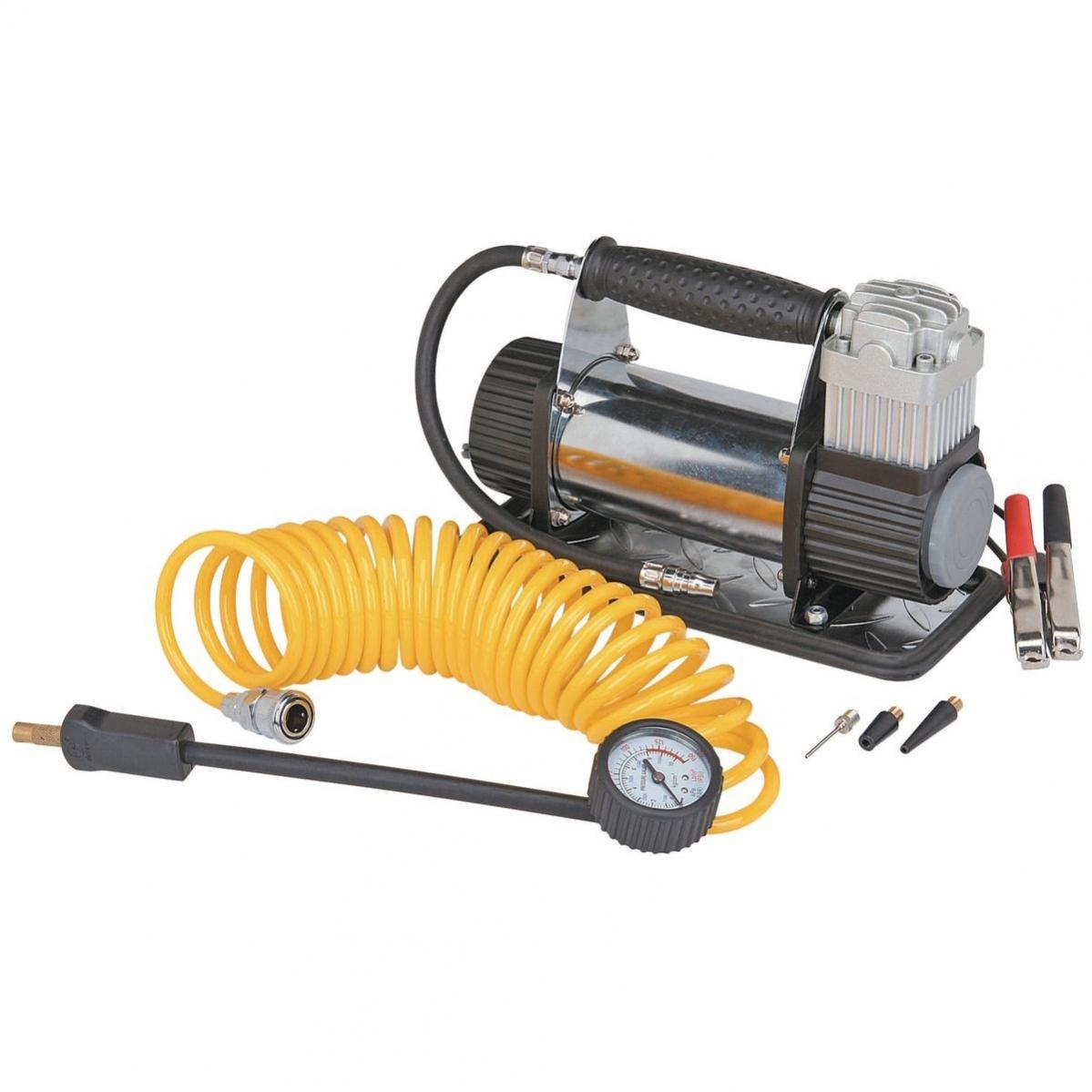

I have the smittybuilt one, the one with more capacity. I think it was $165. Works amazing though. Inflates my tires super quick.
Last summer I blew up 14 inter-tubes for a river float without a break in between them and it was fine the entire time. Highly recommend

What's the deal with this?
It has worked well for me and it is cheap. It has been years so I do not remember details, but it had better characteristics than the competition in that price range when I bought it. Some are really weak units.
