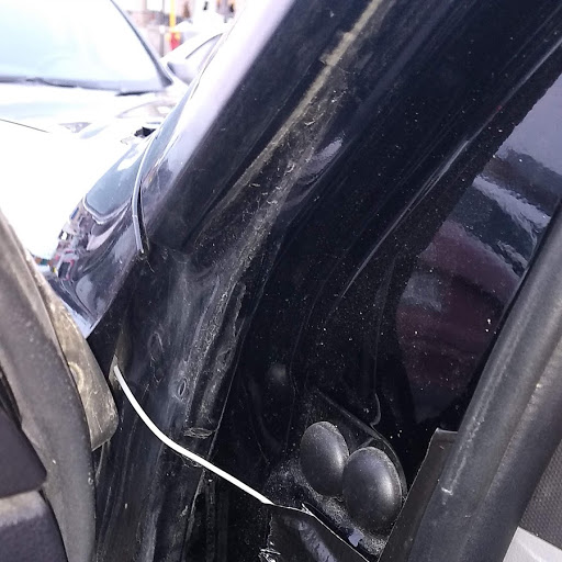

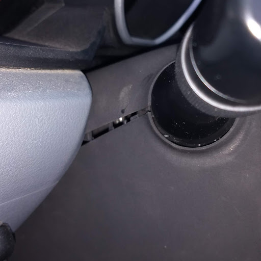

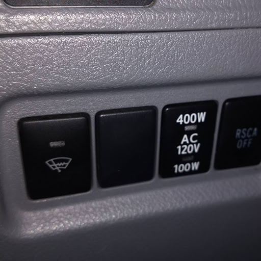

Pics .....
I cannot BELIEVE that they ran the wire through the door like that!?!?!? I have been doing auto installs for 15+ years and have never run a wire like that through the door. I have fished several wire harnesses through the firewall in my 4Runners and never thought twice about doing it. Plus they didn't bother to replug the harnesses!? That's something I always check before I finish my installations. What a freaking joke. This is the reason I don't trust anyone else to work on my vehicle, wow
So if it’s such an important necessity, not just a nice to have, why not purchase a vehicle that has it installed as an option? Again not trying to flame, I know I’m stationed in San Diego so my opinion doesn’t count. I’m surprised it doesn’t come standard in the Limited.
It's an OEM add-on, doesn't mean that it comes standard, Toyota dealerships would gladly charge you $500+ to install one. For those of us that park outside or live in a cold climate, or even hot climate it's nice to start the vehicle and get the fluids flowing as well as letting the climate controls inside the vehicle do their thing before getting into the vehicle. I installed a remote start for mornings like today where there's ice and snow on my vehicle and I fire it up while I'm getting ready for work and it's nice and warm by the time I get in to leave for work (about 10 minutes later)
I hated cold starting and driving my truck before
That’s the most bizarre looking installation I have ever seen… I would be ashamed if this was my own work.
This is a perfect example of why I do all my own electrical these days. It’s also why I tend to stay away from used trucks that have a lot of aftermarket electrical accessories. Unless I can get an opportunity to inspect, assume it was done by some high school kids on a budget with no experience.
OP – Take that shit back. Full refund, and a back-charge for restoration.

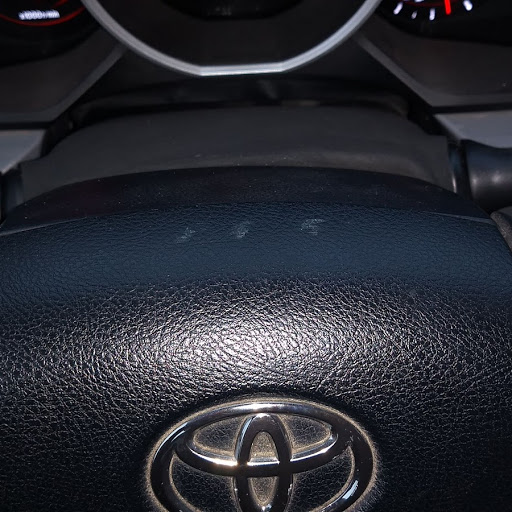

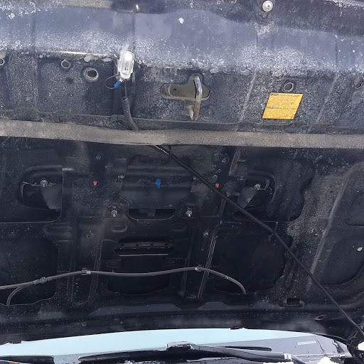

2 more pics to make this fail Complete :( The steering wheel I fixed what do you think about the hood placement ?
Hey Sebastian,
Are you missing the insulation that is attached to the inside of the hood?
Was it removed for the photo or did Best Buy remove it and not replace it?
I’d be upset with that installation. Whoever ran that wire around the door needs a different job
