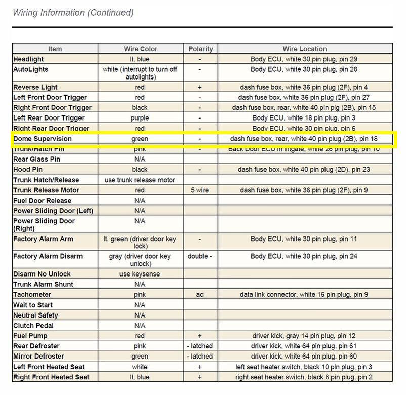

Does anyone know if plug 2b on driver side footwell is on top near fuse panel? I'm not sure if i'm confusing that with plug 2d/2c as they are similar in shape. Does anyone have a good pic from under the footwell identifying it or is there a diagram showing the plug locations to clarify? The alarm wiring diagram indicates I'm looking for pin 18 on 2b and should be green but I have a white wire in that location. It's a 2015 CDN Trail.
