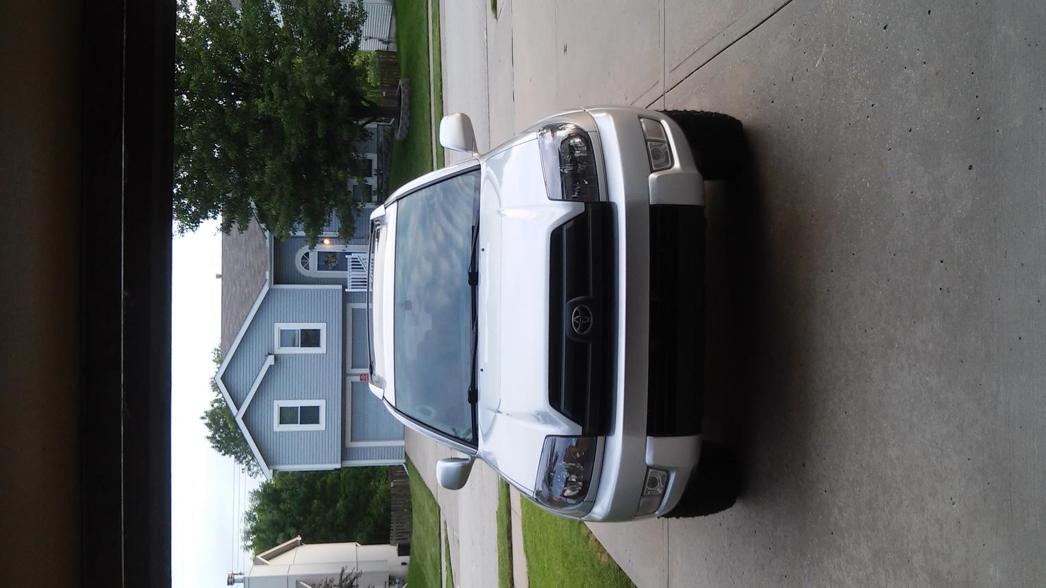

Love mine, Spec D black housing replacements. My stocks were foggy amd shit too, so got.these for $135 off flebay, had them now for 5 months, no leaks, no fogging, and look amazing. Quality looks top notch also along all seams.
