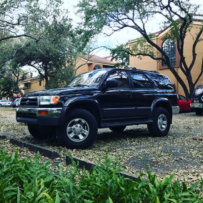

I tow more than I offroad, and the stiffness of the 906s is juuust right with a little weight, and towing a trailer, or even hauling heavy stuff in the rear, the car sits level, so I think the forward rake is just right. I'll post pictures here shortly.

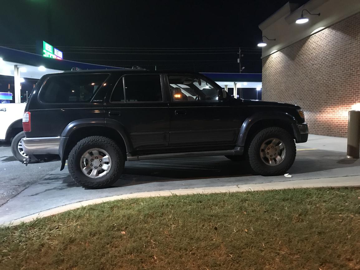

Here it is on a slight grade with around 100lbs in the back. Smack in the middle of a 20 hour trek through Florida scavenging for gas during the hurricane. This is where this car proved to me that it was worth its weight in gold. Family and dog - 20 hours non stop in the heat and traffic. No problem. You can see a slight forward rake, and unloaded it's definitely there, but it's only about an inch.
