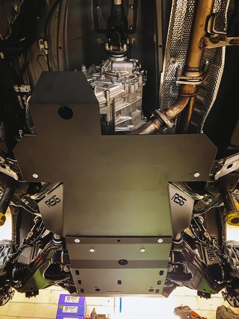

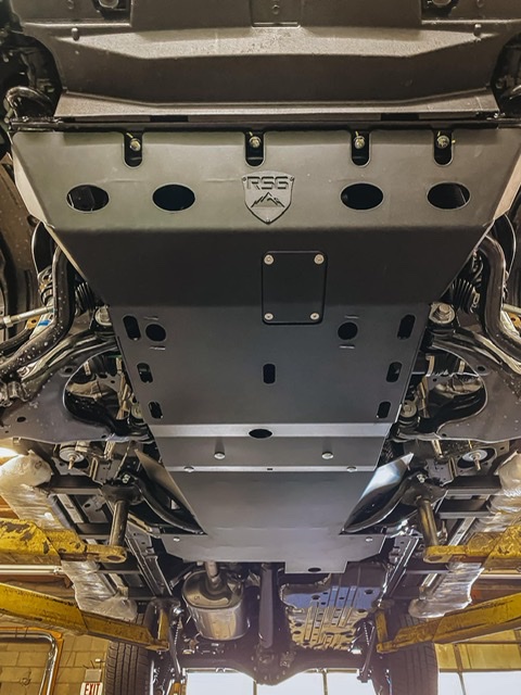

RSG just released a new rear skid that covers catalytic converters too.

Thanks for pinging the thread! I'll try to update the first post about the RSG release.
Looking at their pictures I guarantee I could bash and bend that "tongue" that is supposed to protect the transfer case. In the usual offroading I go on I could bend the skidplate badly enough to push it into the transfer case and bust aluminum. Other than the stiffeners welded to the inside of the plate that skid is unsupported past the two bolts that hold it to the frame.
Flawed design!!

Thanks for starting the thread, I’ve been researching full skids, including fuel tank for myself. I share the same concern with the t-case tongue of RSG. A couple other companies I found were:

I just put on the RSG skids and like them. I think the transfer case coverage seems sufficient and sturdy, and the skids are wider and have better coverage than RCI etc. which is why I chose it. Front and Mid coverage width is similar to CBI, and they also have a nice steel addon you can get to cover the gap between radiator support and bumper to protect the radiator and radiator support. I also like that the exposed, non-embdedded bolts are all thick button head bolts. They are harder to install, but they won't strip if you hit them on a rock.

I bet the coverage is actually adequate, it was probably just the two dimension of the camera. I ended up with CBI steel, including gas tank.
