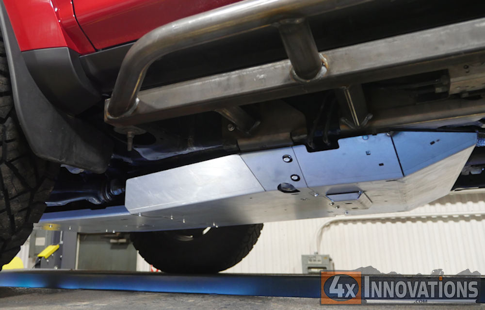

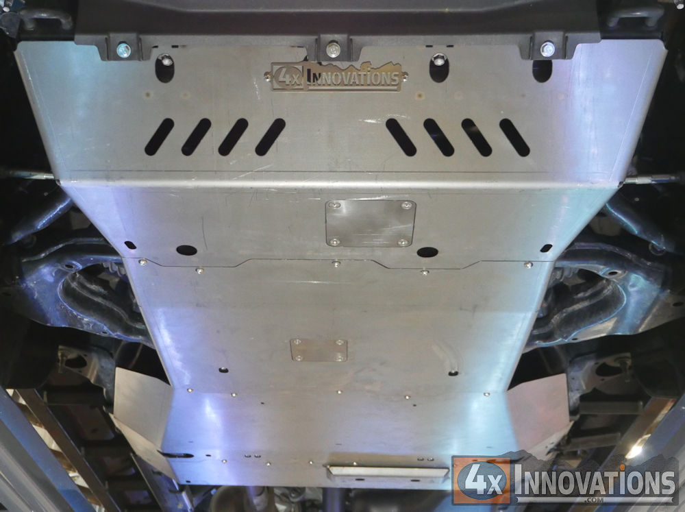

just ordered a set of the 4x Innovations Skids .
Spoke to Adam at 4x about the exposed bolts, and he advised that button head bolts are superior to the "protection ring" found on other mfg's skids as the rings have a much higher chance of getting caught on something.
i think this is a new product for the 4runner for them; dont recall seeing them before. i also have their sliders coming in as well.
i live in california, never really see snow. should i just primer/spray paint it black or should i go for a more substantial coat like por-15 or steel-it spray?

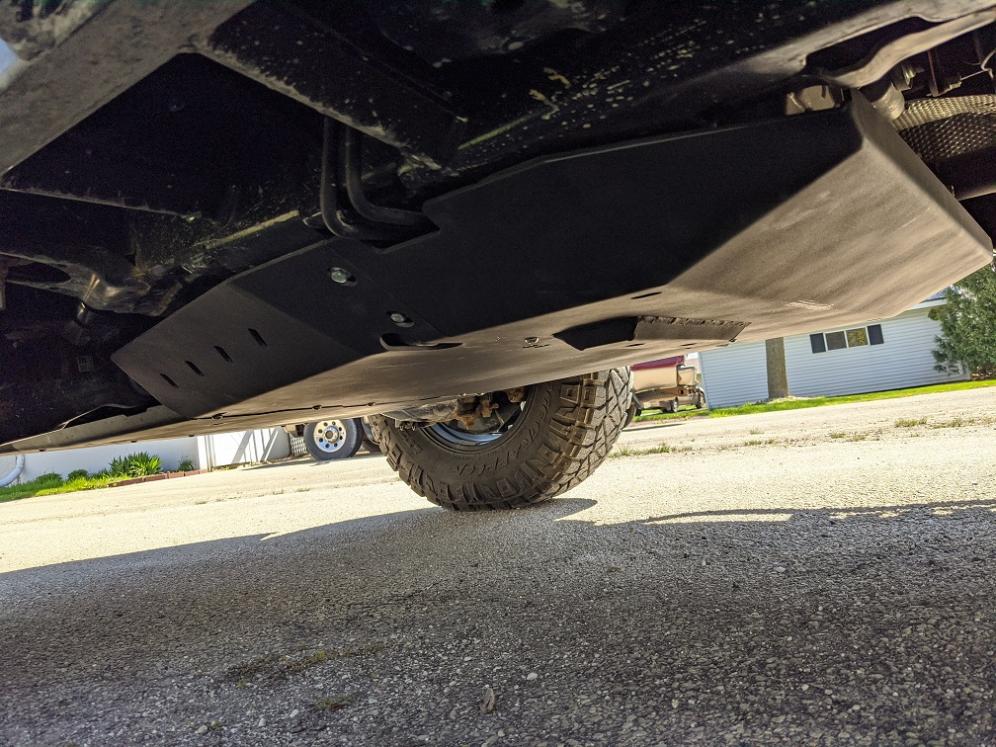

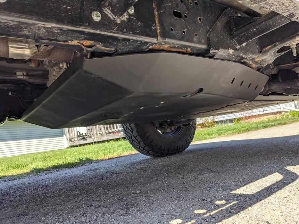

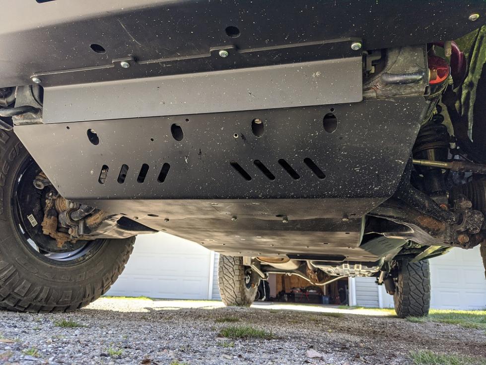

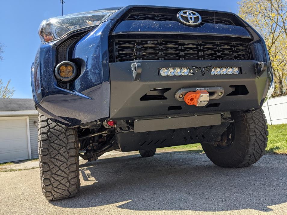

4X Innovations Skids - Here
Real world pics, truck is dirty per usual...
Skids are primed in MasterSeries then spray painted flat black.

Those look solid. They offer a ton of coverage. The only issue I see is the exposed KDSS lines. They could use some protection.
Very true, if there was a sole fault, that would be it.
Not sure if Adam is still on T4R. [MENTION=76968]traxman25[/MENTION] Any thoughts?
Should be a pretty easy fix if you have fabrication skills. Just a small bracket could be welded on to cover them. You could even just cut the OEM KDSS protection plate that it came with to fit against those skids and weld it on. That would probably be the easiest and cleanest way to go. Shouldn't change anything about how it installs.
Basically the very thin stock covers are not doing much more than being a dust cover over those lines. To mount our skids and sliders you don't relocate or move the stock KDSS lines. Also the skids provide the best coverage of any skid out there for the system as a whole.
