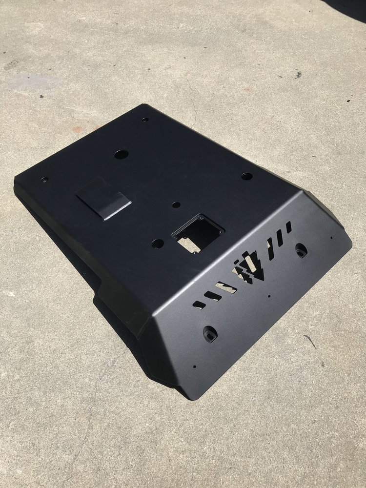

Apparently the OEM plastic filler piece can be cut to fit to close up the gap.
Photo belongs to Brenan - T4Runner.
