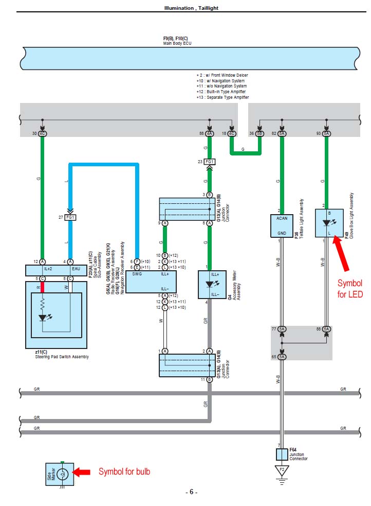

I don't think my 2012 SR5 does have any light in glow box. If it does than the bulb must be burned out but I can't find it because it dark over there :jump:
Turn your lights on and you should see a sickly orange glow.
I've only had my car for 4 weeks roughly and I just found out I had a glove light last week!!
Oh, that "orange glow". This is LED not a bulb.
In the glove?? Cuz that thing looks halogen..... Kind of ridiculous to have our ambient/mood light in our top mount to glow white and our glove to have that sickly orange.....
I might just tear into it and take my chances because it's the only light left in my car that's orange....
Before you tear it up put your finger to it - is it hot like incandescent? In my 2012 SR5 it is cold, yellow, and really dim. Ergo: it is LED :naughty:
Symbol used on the factory diagram it confirms my theory. But this is what I have - maybe in Canada they put halogen it there. :shrug:
EDIT: BTW there is no switch for glow compartment - that is another hint that it is not incandescent bulb.
