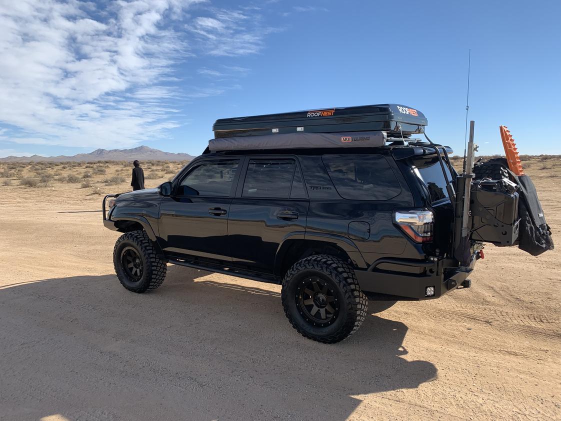

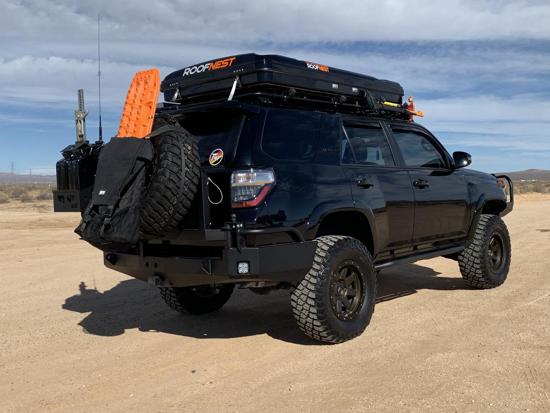

Love my CBI rear bumper

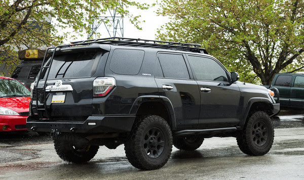

I don't think there would be any benefits to designing a rear bumper like what you described in your picture. The sides would have to angle down to preserve that little bit of plastic to follow that body line which probably isn't that great structurally and would hang to low, hence why most bumpers are flat all the way through to the edge of the wheel well.
I think the shrockworks bumper without the swingout does a good job of trying to preserve some sort of body line.
