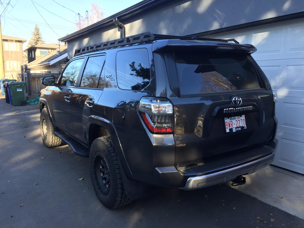

I have Budbuilt angled sliders with the kick out, works fine as a step, lot's of room to put your foot down, very similar to the stock running boards in thta regard and just a bit higher. I can take some close ups if you would like. These are very good quality IMO and you can order them flat if you prefer.

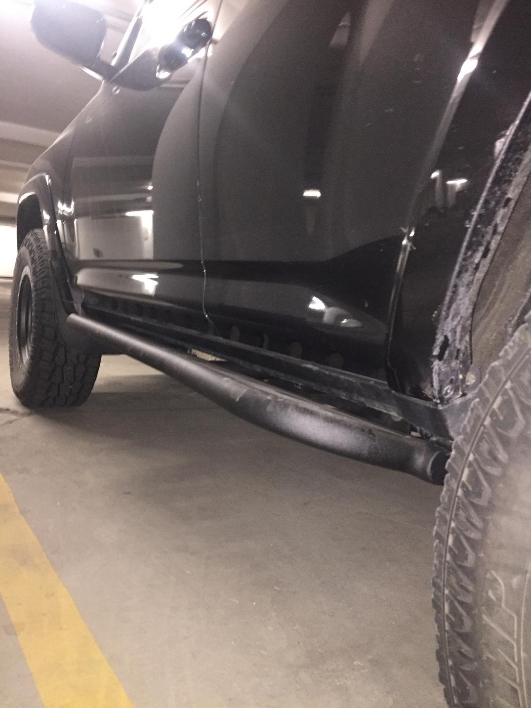

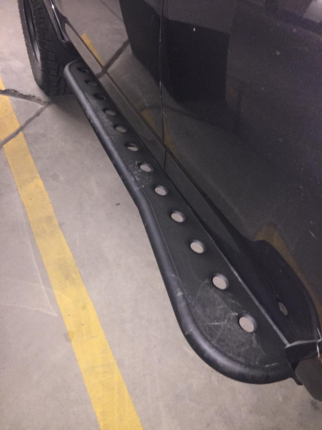

Budbuilt close up pics
Angled with kick out, dimple side down:

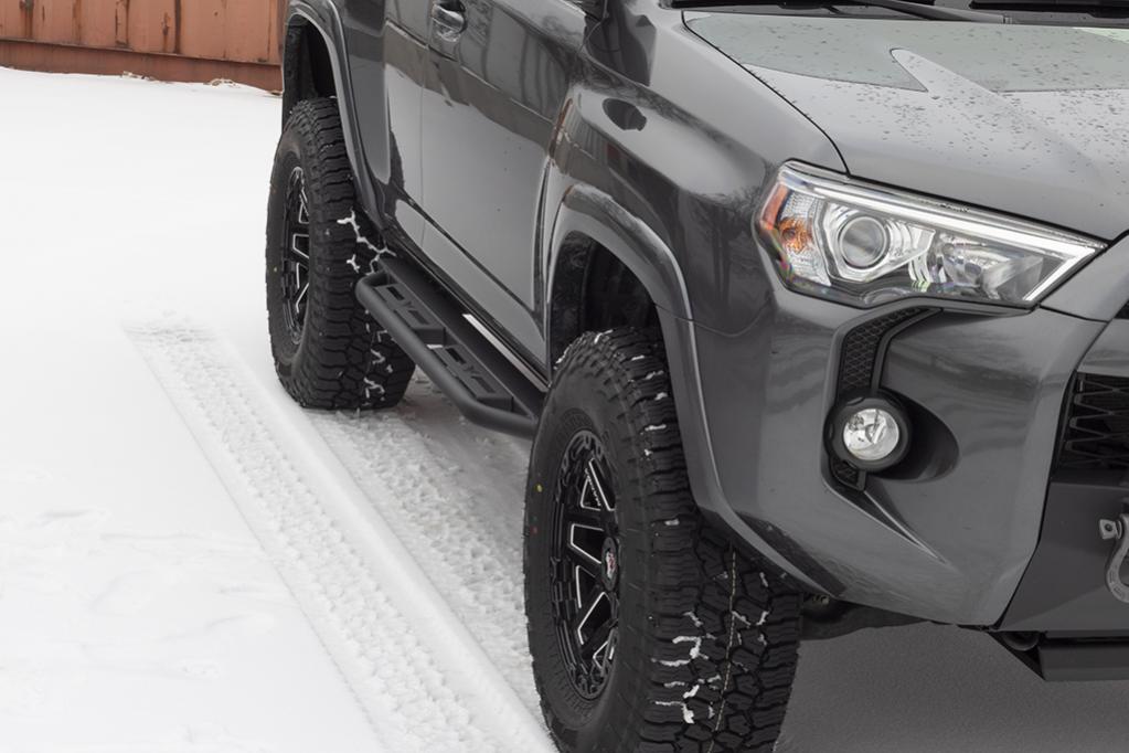

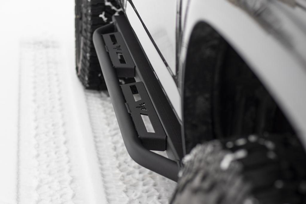

Victory 4x4 Strike Rock Sliders for the 5th Gen
A couple people had questions about how these mount so I figured I'd post the info here as well.
They don't touch the pinch weld. They are frame mounted and have 3/4" gap between the slider and the pinch weld to allow for some flex on a full weight drop. They should never contact the pinch weld.
They stick out far enough to be used as a step and the gussets are placed where you step at both doors.
Victory 4x4 is a sister company to JcrOffroad who has been making Jeep armor for 15+ years.
Let me know if you have any more questions about them!

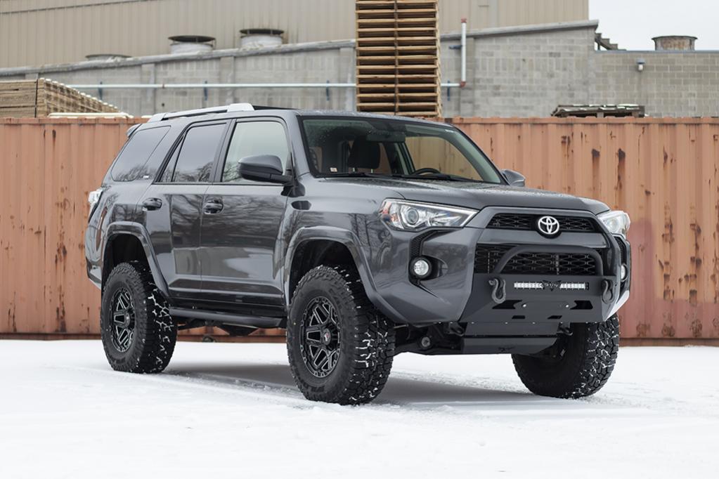

Sharp!!! I like these! Did they come powder coated?
Can you share a link?
edit: nvm...I Googled it :)
