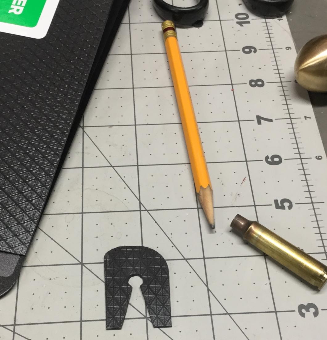

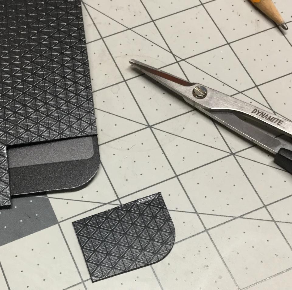

I had the same squeak issue with the splash guard, mainly at highway speeds. Initially it did seem like it was coming from the driver side dash area.
I fabricated some shims from a plastic school binder (thick stock). I slid them in between the body and the splash guard. Eliminated the slack along with the squeaking noise.
