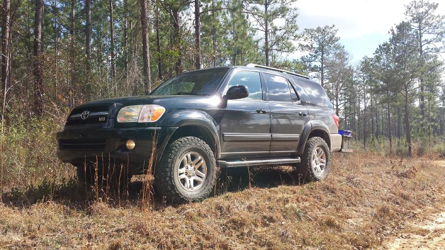

Ended up doing bilstien 5100 struts in front set at 2.5" lift and and 5100 shocks + 1" spacer in rear (until I find a rear coil spring I like).

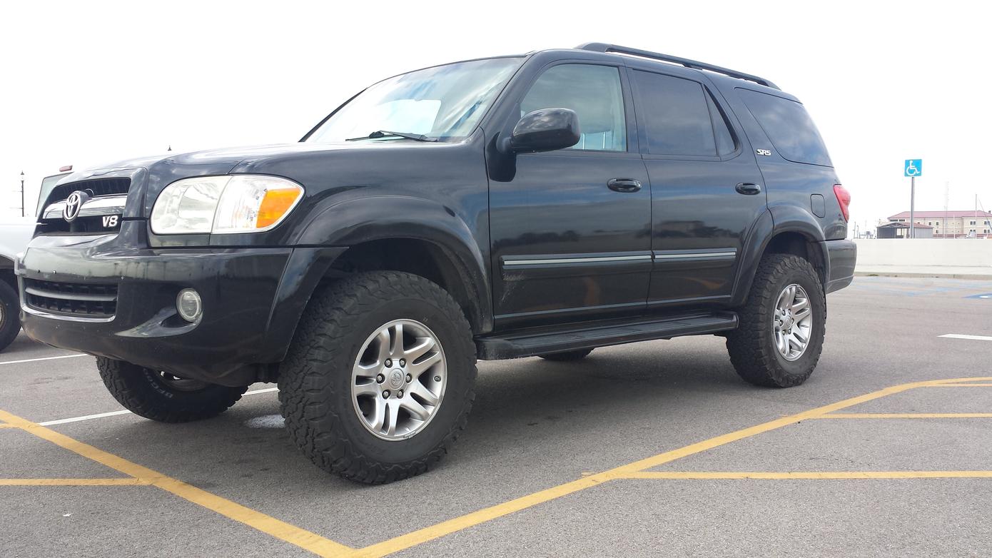

Got new tires on, 285/70 R17 BFG AT KO2, couldn't be happier with them, awesome rubber on and off road.

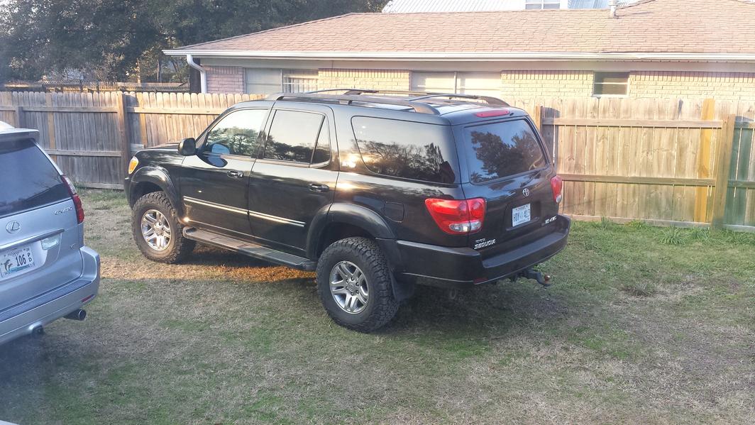

Well I got the 1" rear spacers in. What a total FPITA! I ditched the rubber comes altogether as the spacers didn't fit in them, oh well. The rear lift isn't noticed which is perfect, it shows up on the tape measure but visually you don't say huh???? It that lifted. Just looks perfectly perfect.
How did I miss that photo! Very nice and subtle! What is didn't want was my 2002 4R over again. It is great but it isn't the Sequoia.

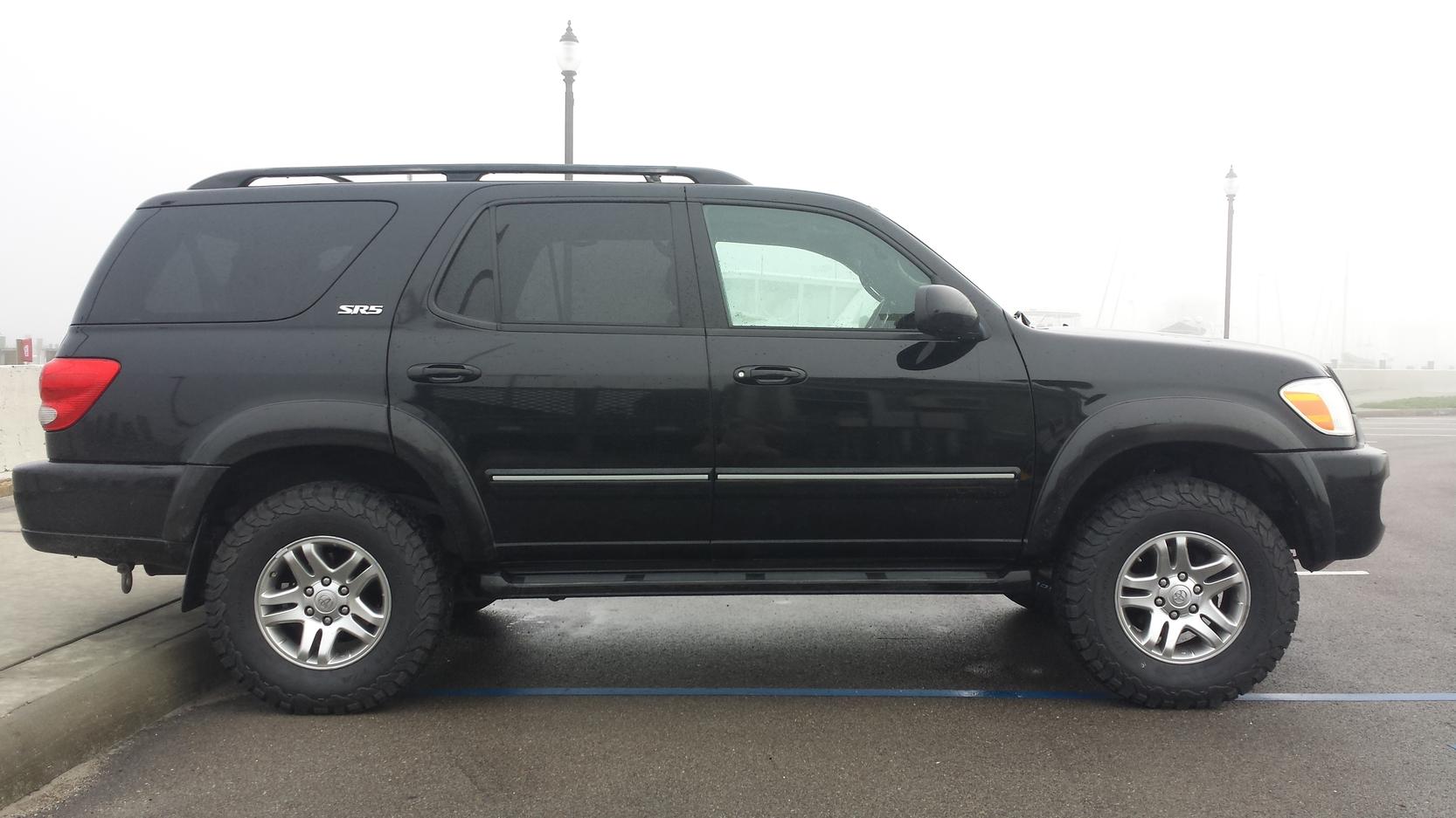

I guess there were no issues wth my 5100's set at the 2.5". I left the factory shocks in the rear. I can't beleive how nice the truck drives lifted with the bigger tires. I did notice when i had the new wheels and tires in the back the rear was sagging quite a bit. I dont carry a lot of weight on a regular basis but i may replace the springs and when i do i will upgrade the rear shocks.
I recently lifted my 03. What notch on the Bilsteins are you on? I got the ride height with 5 different settings and went with the third, looks similar to your truck. Did you need to cut to stuff those 285's? I already had to hammer in the metal near the pinch weld and cut part of the inner bottom of the front bumper to help clear mine. Love the look and way it drives.
