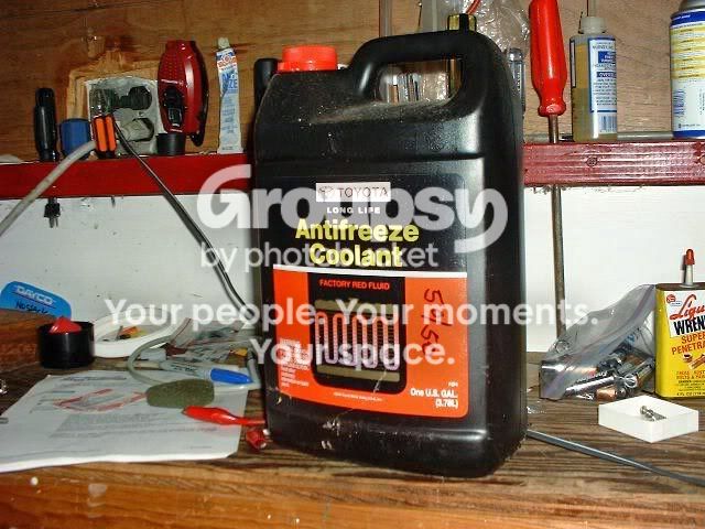

I do not have a picture but you must drain both sides of the block. You do not actually remove a plug. It is more like a fitting on the side of the block with a little metal tube. You just loosen the screw and the antifreeze runs out the metal tube. They are towards the rear of the block. You can attach a rubber hose to the fitting to make less of a mess. Drain the radiator and both block drains and there will be very little antifreze left. I used original toyota long life antifreeze. It is pinkish colored.
And typically refered to as "the red stuff"
coolant.jpg~original
Thanks, I will check tomarrow for the drain plugs. It is really strange that there is now the green fluid in there now. It seams that when I bought the 4runner new it did have the red coolant in. Must have been the mechanic when I did the 30k and 60k. I will now put back in the Toyota long life coolant.
It cost $ 19.26/gallon at my dealer. It is concentrated so pick up a gallon of distilled/ di-ionized water from the grocery store to cut it with.
If you want a full change in fluid, then change it twice. Drain it one weekend then drive it a week and do it again the following weekend. That way you replace most of the coolant.
