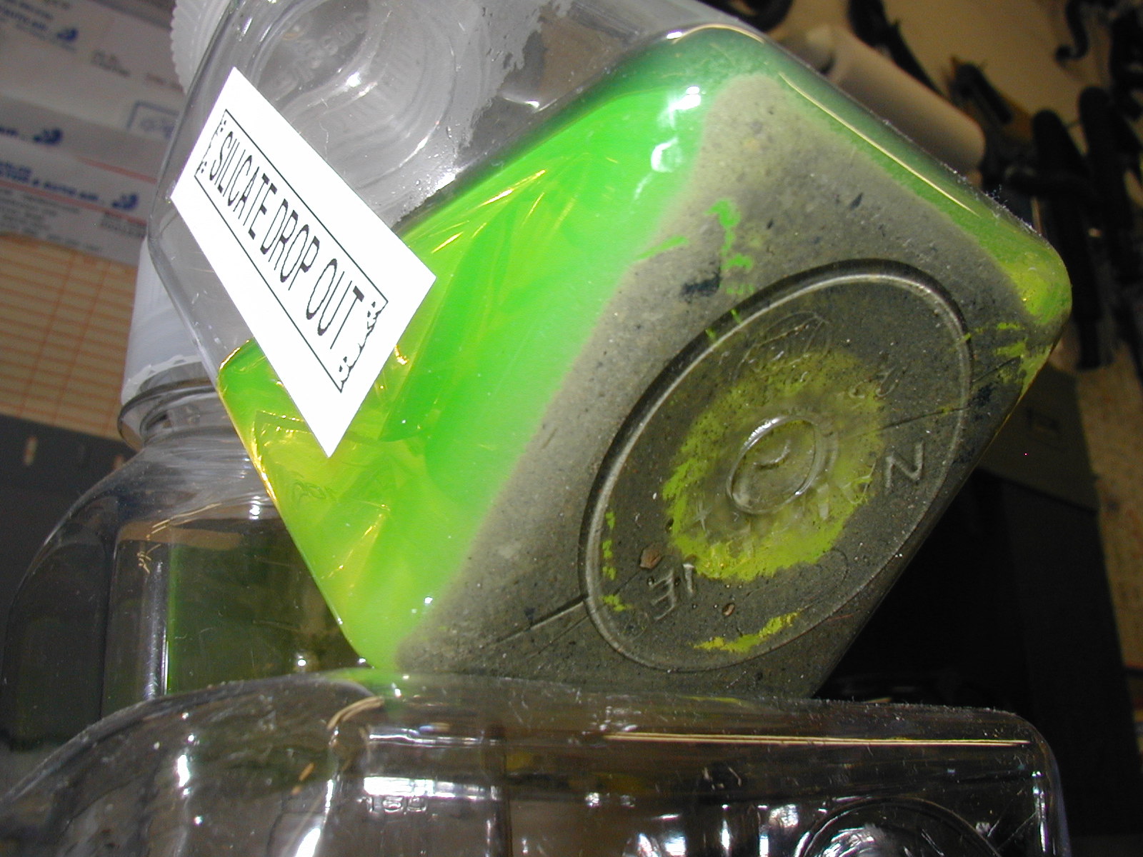

There's a reason Toyota phased out LLC in favor of SLLC, one of the many reasons is this:
That's Silicate that has actually fallen out of suspension in the coolant itself, as you can imagine that then sand blasts the inside of the engine and cooling system. Is it an issue if you flush the coolant every 30k like the old days? Probably not, is it an issue if you're trying to run the coolant 5yr/50k (like Toyota "Red") or longer? most likely, yes.
