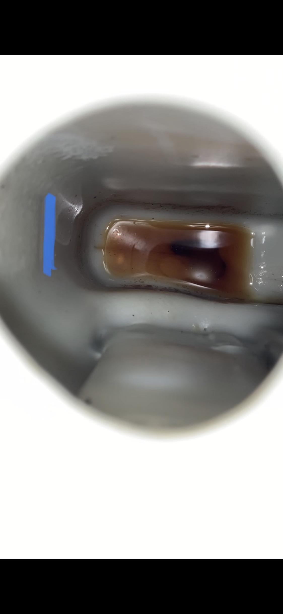

I just drained the radiator and it looks like it had either orange or amber in it. Hard to tell. My wife had an indy shop change it about 6 years ago.
Edit to add that I'm looking at it again and it looks maybe red?

that looks like cough syrup.
I've never used Toyota Red so i wouldn't know.
If i was in your situation I would consider getting a professional flush at the Toyota dealer that way everything that was in it before is fully flushed. This service usually runs about $120-$140 and a good chunk of that includes the cost of Toyota coolant.
For BTO the coolant looks fine, as the Toyota red coolant should. The key after changing the timing belt and water pump is to get all, or as many air bubbles out of the cooling system.

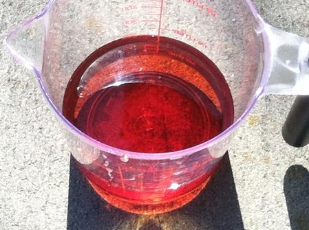

I have some Zerex Asian pink coolant I use in my Tacoma. Is it OK to mix the pink with the red?
Is it ok to Mia pink with the red? Good question. I think this is pink and not orange
