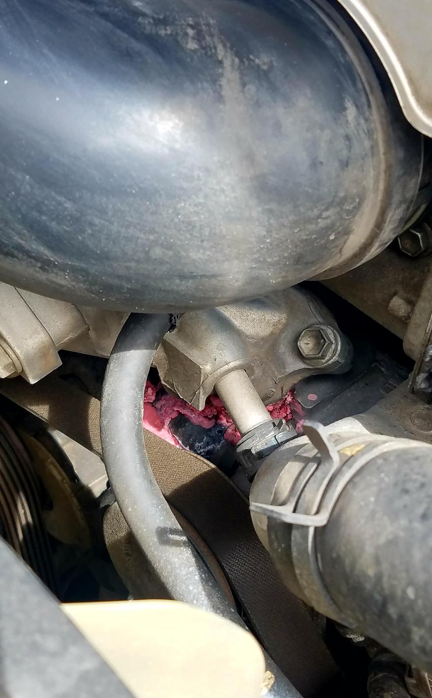

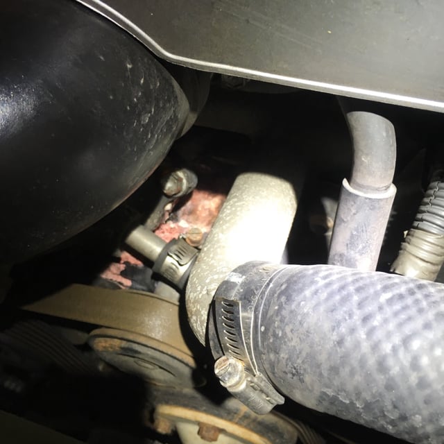

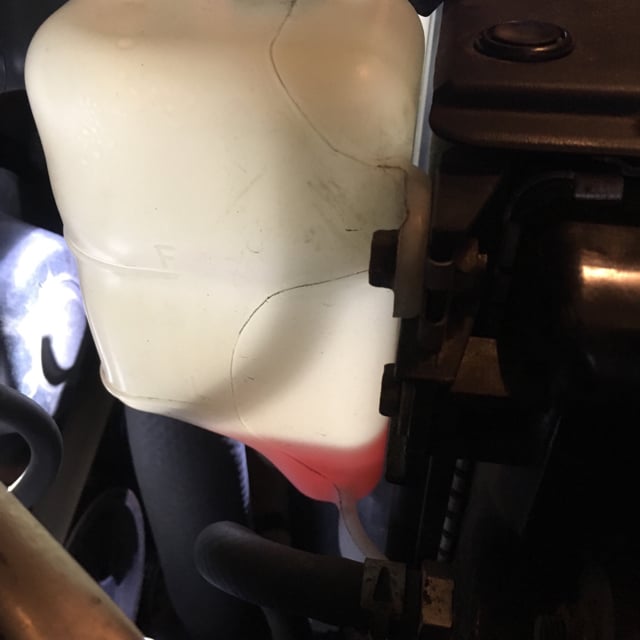

Anyone had this issue? Coolant in reservoir is low. But never below level in the pic even after refilling. And there's some crusty pink coolant in pic #2

So, I replaced my water pump and still leaked coolant. Turned out one of my hoses had a tear in it. Take a look at the hoses nearest the crusty coolant.
The bottom rubber cooler hose on mine was also dripping after my TB job, but it turned out that the system really needed to be burped (bubbles came out for a good 5+ seconds) and my new thermostat was also stuck (there was no hot air from vents with heater on highest setting). I think the two problems combined were causing enough of a back pressure that coolant was leaking not through a rip but past the clamp on top, glad that you found the leak before too much of the pink gold was wasted:)
thanks for all replies. keep them coming. I plan to look at the issue this weekend. the Timing belt and pump were replaced at 117K. Car has 157k now. Will look at hoses - that sounds easier than gasket replacement :)
