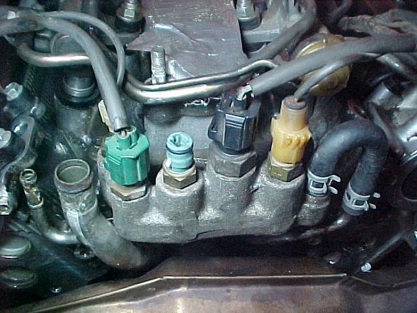

So I was driving around on the beach and then on the way back my 88 4runner started smoking real bad and I found out all the coolant from my radiator was leaking out. I can't find out where from though is pouring out towards the back of the engine / dripping of the transmission. anyone know what it could be/how to fix it?
I just dealt with that….. replaced one, then a week later another, a month later another…. Replace every hose you can find back there.
It's isn't super hard. I had to buy some of those 14" long needle pliers for a few bucks at Auto Zone.
You probably won't see it unless you get something to stand on and get your yourself (line of sight ) up so you can see down the back of the engine.
