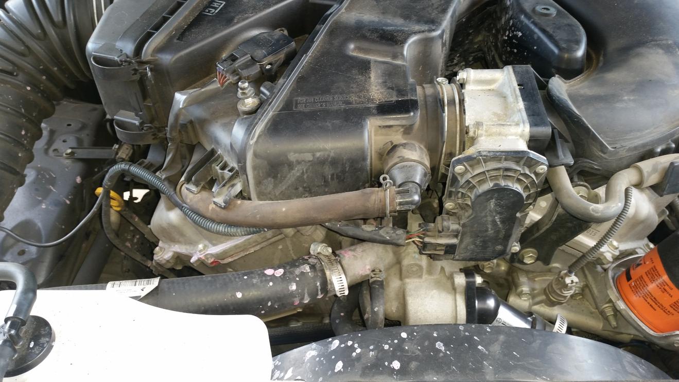

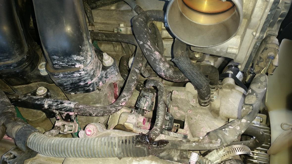

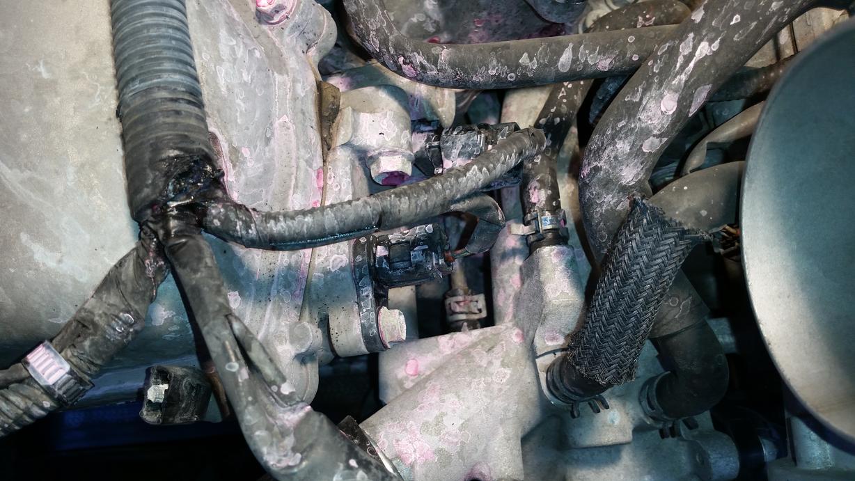

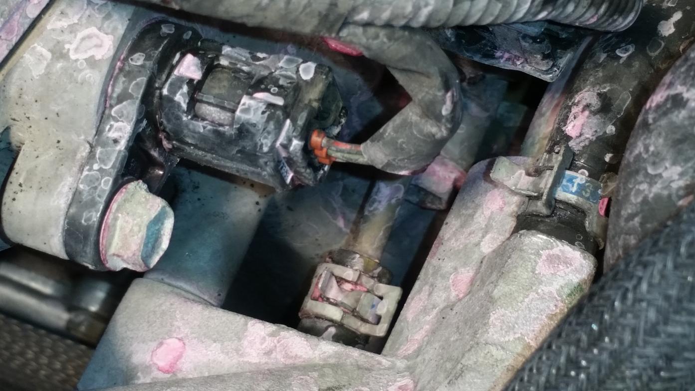

Did some investigation to the coolant leak. Here is what I found so far....
First 3 are what I was seeing as a coolant leak.
Next is when I removed the air intake assembly.

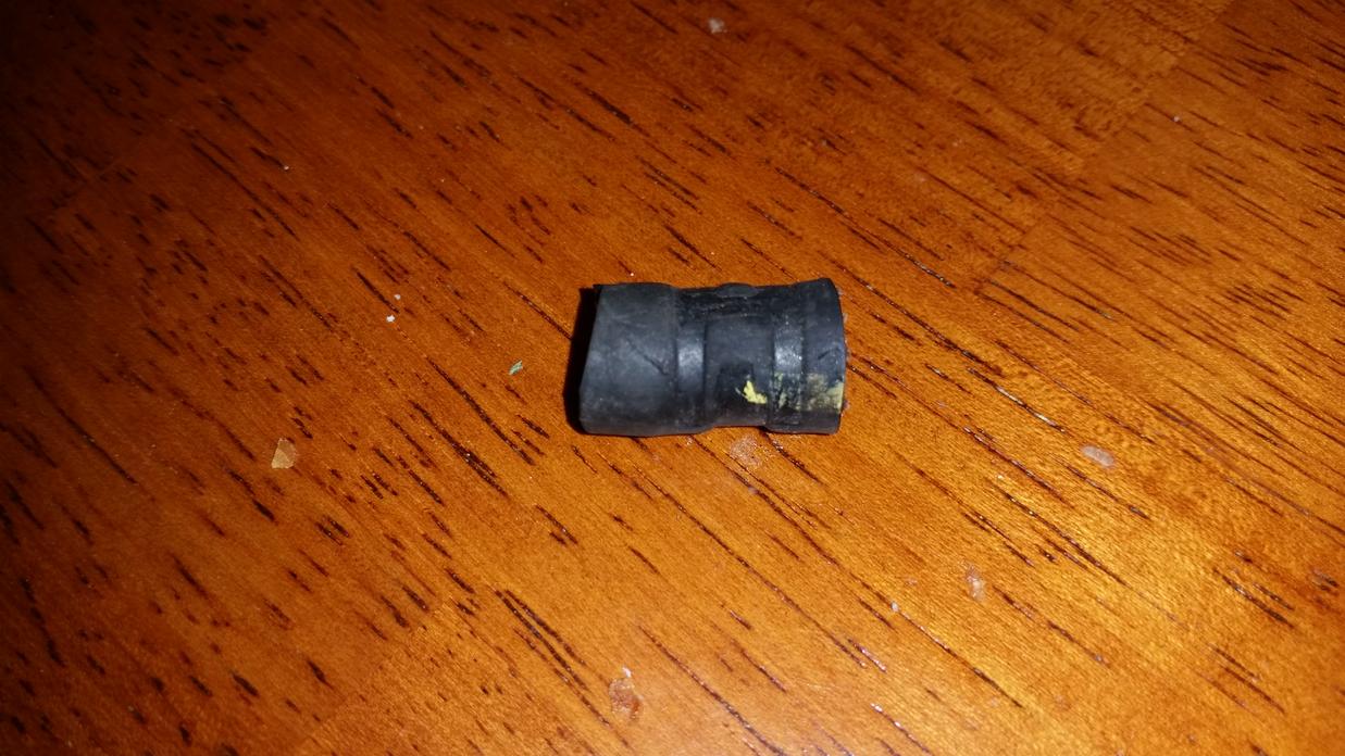

I tried to run the 4 runner without the air assembly on to see if I could find an active leak, but it would not start without the unit attached. I then assumed that, from the pattern of the spray, it may be the By Pass Hose (16261) where it was attached to the metal line. No Dealer had it in stock, so I cut off the end of the Hose and used a screw type Hose clamp to secure it.
We'll see if the leak stops, then I'll order a new Hose.
