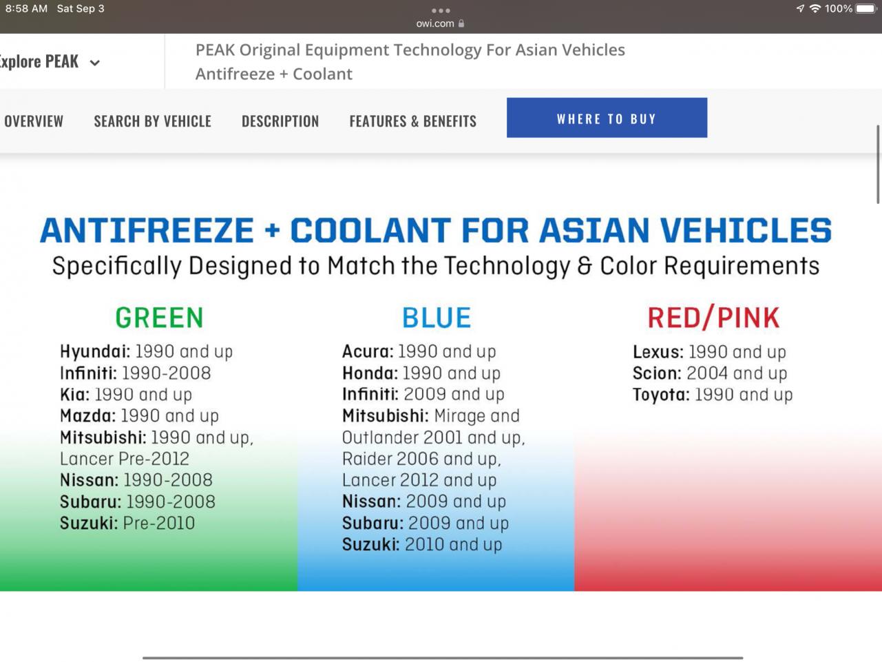

These coolants in the aftermarket are formulated to be compatible with all toyotas. I used zerex in my 4runner and peak asian in my sienna. Only the toyota coolant has a pink and/ or red versions. You will be fine with prestone. The best practice is to change it every 60-80,000 miles no matter which you use.
Hell I used prestone green universal coolant in my Lexus IS300 2001 for the last 200,000 miles and it never had any issues all the way to 300,000 miles when I sold it. If it states safe to be mixed with all coolants, use it. The science is much better today than 30 years ago.

I found the Peak asian at a discount store last year and it was $7/gallon of concentrate. Hard to pass up.
