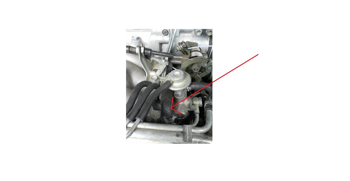

The stuff i used was Irontite, the guy at rebies said it was the best stuff out their. And before i used it i flushed my system with Irontite thoroflush....the irontite will condition the seals for my water pump...After all of this i fired it up drove it with the heater on high, when i got back their was a small drip...Sooooooo i popped the hood and saw a hose that looked like it was cracked near the intake, i got a pic and was wanderinrg if you guys can tell me what it is.....hopefully thats my leak!!

So when i did change the hose it did fix my problem. When it leaked from the hose it was leaking down between the intake and valve cover, and when it got a big pool it was dripping down the side of my engine....thats why i thought it was my head gasket...
