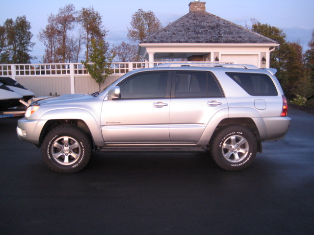

I have 1.25" lift in front. Though my front setup are not spacers, I measured it 1.25" higher than its stock height(before), while the rear is the same.
Click pics below, its how 1.25" front lift(only) look like for reference and I have 16" wheels and stock size tires.

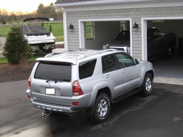

imo, you'll be fine with a 1 & 1/2 front only lift, it should make the running boards level, at least on 06 & up. heres mine with a 2 in. front & rear air bags filled.

Sorry I don't have any better pictures, but I'm running the Bilstein 5100s on the 2.5" lift notch and no lift in rear. It's nose high, but when measuring the differences, it's only a ~1/2" difference between front and rear.
I like the way the tire in the rear seems to "fit" into the wheel well. It fills it nicely. I think maybe the front on the 1.75" ring instead of the 2.5" would bring a tiny bit of rake back into it, as well as make the front tire fill the wheel well more. Looks great, thanks for the pic! I've found the set of 4 Bilstein 5100s for $332 shipped, so maybe I'll pull the trigger.
