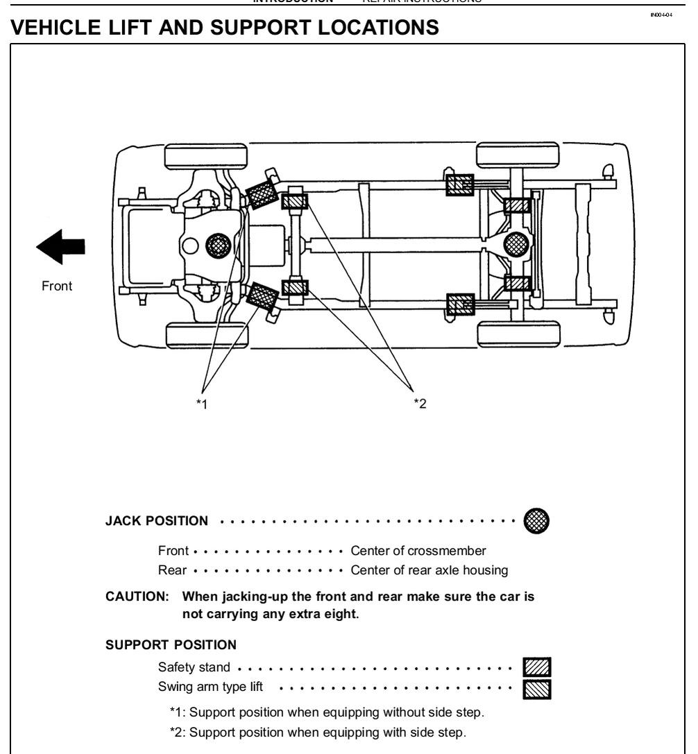

Here's a diagram, use the round points to jack and the frame to support. I personally have not used the support areas marked #2. The frame works perfect with the right size jack stands.

i have jacked my truck up 100's of times and still wonder if some places are ok or not, i'm printing this out and hanging in the garage as a quick reference so i don't kill myself or the dog anytime soon. lol, thanks for that, it's one thing to look at ti and be like awe that's ok it's another to know where the designed lift points are, thanks again.
