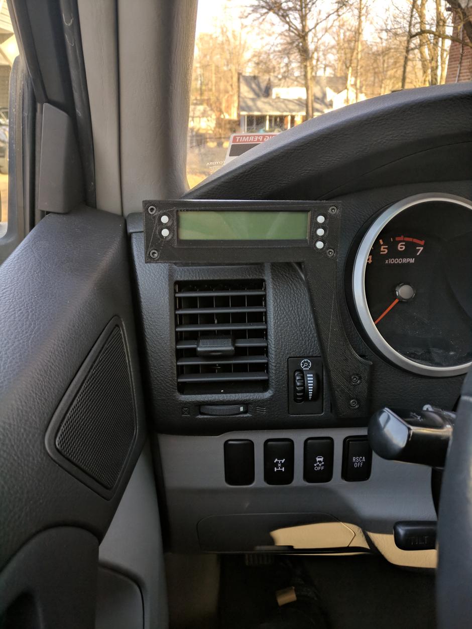

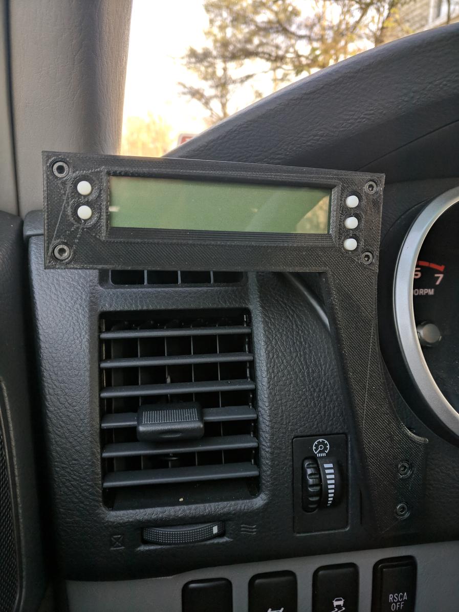

I couldnt find a way to mount my Scangauge II that I liked, so I made one.
It holds the gauge to the left of the gauge cluster, somewhat in front of the drivers side defroster, without obstructing it too much.
After about 8 different revisions, I have one I'm fairly happy with.
Was going to post the thingiverse link for you all, but it seems that theyre down for maintenance at the moment. so here are some pics of what it looks like currently

This is really neat. If it were mine to play with I would radius the corners around the gauge, or a heavy chamfer like the edges of the dashboard. Make the right edge contour compliment the gauge cluster circle better at the bottom.

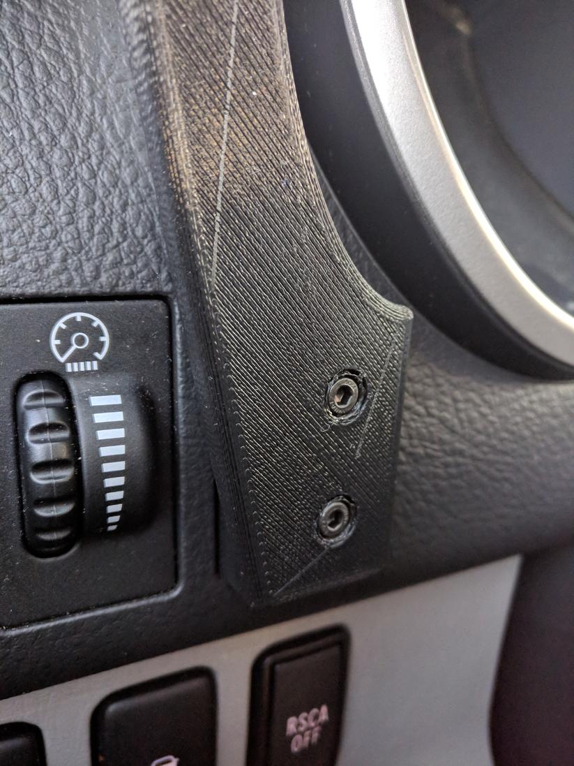

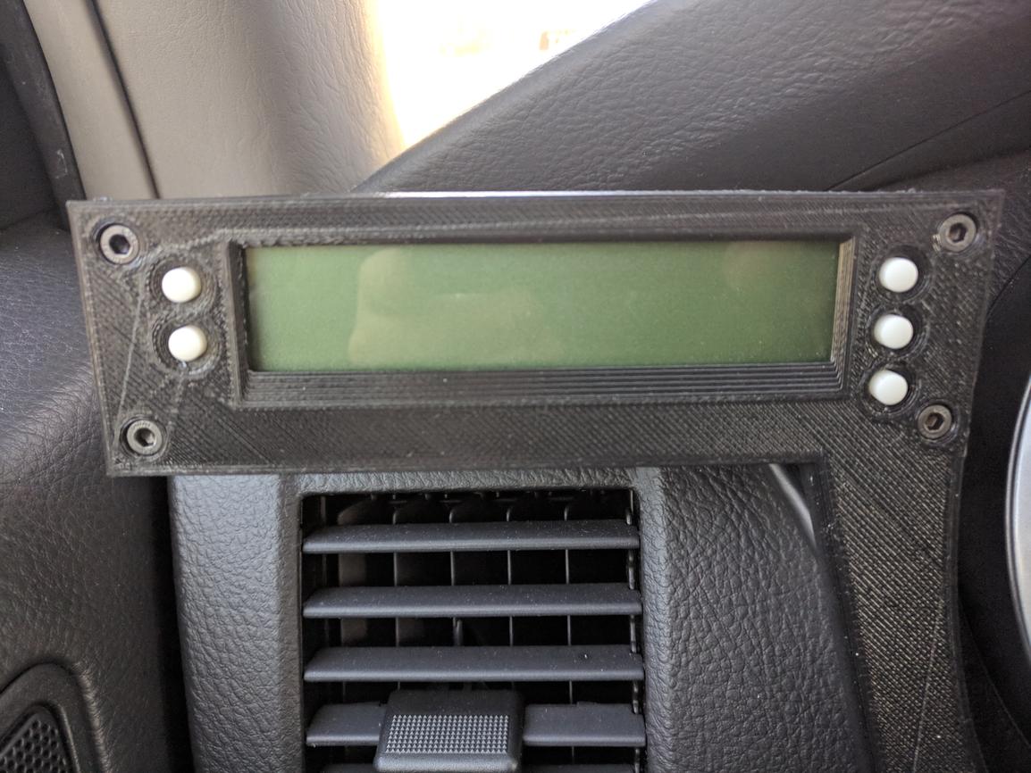

I've made a single revision since the pictures in the first post, where I've filleted the top, left and right sides of the face a few mm, and cut out some 1mm grooves for the 4 selection buttons.
I probably wont make many more changes, at least for a while. I've decided I want to get it printed in ABS as soon as possible, and I'm having some issues with the prints stopping before the "arm" is started.
If I give up on ABS, I'll try PETG, just so I wont have to worry about it drooping in the car over the summer.

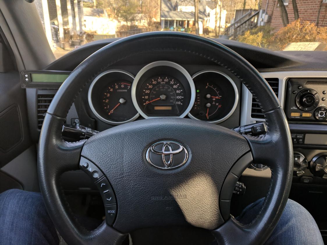

Reviving my own dead thread with an update and some pictures.
So I polished the design of the mount I posted earlier, adding some rounded edges/details, making it more print-friendly, etc. Ended up with a mount that I was happy enough with to leave untouched for a few months. unfortunately, as the weather got hot, it only took a couple days of sun to melt the PLA print and the mount drooped about 45 degrees.
After several more failures trying to print it myself in ABS and PETG, I caved and sent the design away to Shapeways to get printed in their "Strong and flexible plastic" which I believe is vinyl.
It came out great! they have way nicer/better printers than the cheap one I have, and it shows in the finished product.
Unfortunately I dont have pictures of the now melted PLA version, but the one I sent to shapeways is the same design. Now here are a few pics, and the link where you can get the files yourself is in the album here: https://imgur.com/a/OhQANOD
