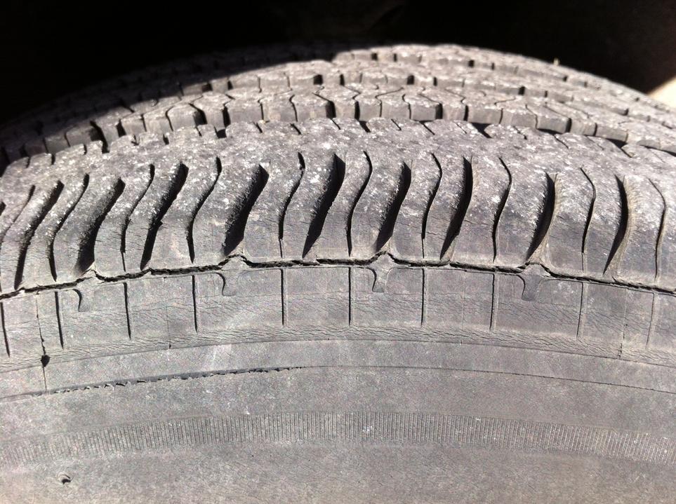

Should i be concerned? looks like the tread is separating from the sidewall. tires are about 3 and 1/2 year old, < 25k miles, parked outdoors exposed to elements in the northeast. thanks

I would not want to drive on those! The more laterals you do the more likely the tread is to slip right of the tire! I imagine Michelin or whereever you got em will replace those no question.
the tire tech told me it's ok, just some tire molding issue in the manuf process, no worries. i think he's full of it.
He's definitely full of it. Call Michelin or talk to the tire tech's boss (or where ever you got them from). You might get the shaft on the warranty (if you have one).
What type of tire exactly is it? (Cross Terrains, LTX, LTM M/S2, etc etc)??
This is not normal "wear and tear" here and should be covered. Make sure you use the word "safety/unsafe" when discussing this with the boss or Michelin...that will get their attention.
Go to the installer in person, don't use the phone, talk loud so waiting customers can hear and say something like "What do you mean you're not going to warranty these defective tires you sold me!"
It works for me every time.
it's michelin symmetry line on my other ride. Thx all for the tips, I'll drive it to the tire center (costco) where I got them installed, to have it looked at. The tech who told me it's "normal" is from a diff store.

Looks like dry rot deformation to me, possibly valid for a warranty replacement. Hope it works out for you, my factory Duflops did the same thing after about 2 years and 25K on them. They were also a little chewed on from the trails,
Also, look on the side wall for the date the tire was made.
Check out Tirerack to determine how to find the month/year your tires were made. They might of been old to begin with or it may just be form the elements sun, concrete. All of these contribute to dry rot.
Tire Tech Information - Determining the Age of a Tire
Like Darklight says. Check out the DOT date code to start. Note: I have had Dayton AT tires not look this dry rotted after 6 years outside.
